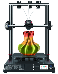

2.3d printer

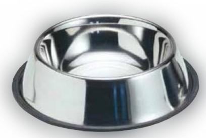

10. Dogs feeder

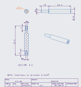

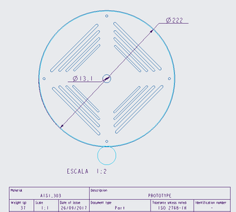

Step 2: Step 2: Manufacture All Parts
To manufacture the pieces I attach the 2D plans. You will need a 3D printer for the plastic parts and some sheet steel that can be substituted for wood if you don't have a sheet metal cutter.
Follow 2D plans for print frame in PLA or ABs, enough.
For steel parts, is needed an axe, for allow the rotation of the sheet central metal. For allow eggs spin, should be enough with plastic part which fix eggs in the middle part.
It's important take 12 volts for every electrical part. In order to get the same power supply for every part.
