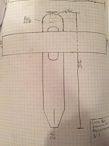

Step 2: Start to Make the Fuselage
2- Start by cutting a piece of foam board 15 inches long by 9 inches wide. This will be the fuselage, be sure to follow safe handling procedures when using the xacto knife. Next, using a square, mark the width of the foam board in 1.5 inch segments. Next, using the exacto knife, follow the lines you just marked exactly two times. The goal is to cut the top layer of paper, along with the center foam, but not cut deep enough to separate the pieces entirely. Once this has been done, the roll the fuselage such that the cuts you have made will be facing the outside. Hot glue the two edges together. Now you have completed the fuselage.
Step 3: Making the Wings
To start making the wings you want to have two pieces of foam board that are 20" long and 3" wide. You then want to have the top piece have an angled piece of foam board on the top so that you will be able to thread wires under it latter in the design process. Next you want glue the top and bottom wing pieces 2-3" (depending on what style you want your plane to have) from the front of the plane. Make sure that your wings are right over each other, this is important for the wing supports. After the glue has dried and your top and bottom wing are in place now you can start to put in the supporting posts.For our design we put 4 on each side, two in the front and two in the back on each wing.

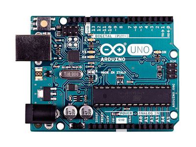

Step 7: Arduno
Next, the Arduino must be set up. To begin, unpack and connect the Arduino to the computer using the supplied cable. If you do not already have the Arduino software, it can be downloaded, using the link found in the directions of the Arduino. Next, open up the Arduino software and create a new program. To do this, go to file, and click new, name it whatever you would like. Next, copy and paste the code, found at the bottom of this step, into the Arduino software. Finally, click "upload" and the program will be installed and will automatically start running every time the arduino is connected to power. The wires for the led's can be connected to pin 12 and 13, for the positive, and any of the ground (GND) pins, for the negative side of the led's. The Arduino will run off of a 9 volt battery, to connect it, use a wire to connect the positive (+) side of the battery to the "Vin" pin, and the negative (-) side of the battery to any of the ground (GND) pins. The Arduino will turn on and start running the code. If you already connected the led's, they will begin to blink.

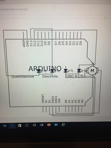

Step 8: Making the Circuts
For this biplane, two different circuits are needed, one to control the motor and the other to control the lights that will be on the ends of the wings. For the motor circuit, a switch, a motor, a 9 volt battery, and three wires are needed. First connect the one end of a wire to the anode part of the battery and the other to the switch, then connect another wire end to the other side of the switch and the other to one side of the motor. Last have one wire connect the motor and the battery to complete the circuit. Solder the exposed wires to finish the electrical link. For the next circuit an Arduino, five LEDs, a 9 volt battery, and eight wires will be needed. First connect the battery into the appropriate pins of the Arduino, giving the Arduino power. Then connect the 5 LEDs using six wires. Last connect the wires to the Arduino by putting the wires in the appropriate pins. Solder all exposed wire to finish the electrical link. DO NOT solder anything into the Arduino. It is important to know that you can program the Arduino to do what ever you want, but for this project it is realistic to have them blink in unison.
