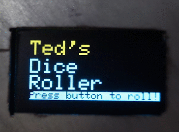

My finalized design employed the use of a 128x64 pixel OLED display, mainly because of its flexibility: I could easily change my graphical interface as opposed to, say, seven-segment LED displays which severely limit the number of digits that can be displayed. They also are more complicated to use because you need many output pins and therefore would be forced to add extra components such as shift registers to make it work with a microcontroller of a limited number of pins.
The screen I got on Amazon is also is dual color, in a sense. The first 16 rows are yellow, and the rest blue. This was perfect for my application because it fits my graphical layout (number of dice rolled at top in yellow, and blue for the larger text result). Plus, it just looks nice.

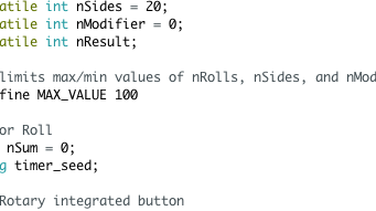

Now that you've got everything connected up to a breadboard, you're ready to put your program together.
What I needed it to do: interface with a screen, read the input from two buttons, and adjust values based on a rotary encoder.
Luckily, communicating with the screen was made quick and simple because of Adafruit's Libraries. (SSD1306 for interfacing with the driver chip for the screen, and their GFX library for quickly and easily adding text or shapes to the display.)
The rotary encoder used external interrupts, which are a very useful feature that the ATMega328 has and the Arduino IDE has support for. It allows code to be ran only when a pin changes, and otherwise will not slow down the main loop() program by polling with the digitalRead() function. You can read more about this useful feature here: http://playground.arduino.cc/Code/Interrupts
I started with getting the OLED display to work. Luckily adafruit has a library (link) to easily interface with the display I was using (the SSD1305) and adafruit has a lot of information about it here: https://learn.adafruit.com/monochrome-oled-breakou...
After laying out my text and roll numbers and results where I wanted to, I made it so the user could be in different selection modes to change the number of dice to roll and the number of sides. I used a random seed of the number of milliseconds since the device was on, and generated a random number each time they pressed the roll button. I also had the screen refresh only when a number was changed, to reduce unnecessary CPU overhead.
Feel free to find and use my code on my github repository at: https://github.com/tedmyers/Dice_Roller

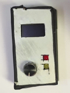

Instead of using a generic black box housing, I wanted to make my own unique case. I also liked the idea of making it out of metal and luckily I had some scrap laying around from taking apart an old fax machine.
The scrap metal I used can be seen in the bottom right of the image (the long grey rectangle with slots cut out) To shape the metal to the case, I started by using calipers to measure my electronics, and made a 2d CAD image of the screen, knob, and button layout in SolidWorks to aid in cutting in the right spots. Next, I printed this on a piece of paper at 1:1 scale, cut the paper to shape, and taped my image onto the metal sheet. After using a marker to transfer the cutout shapes over, I had a template to cut holes for the case that were placed in the exact right spots.
I then used a dremel with a cutting wheel attachment to make the hole for the buttons and screen, and a large drill bit to make the circle for the knob. If I were to redo this step, I would have drilled out my button holes as well, as it is very difficult to make square holes of the size I needed, and I ended up using round LEDs to reach the buttons anyway. Oh well, now I know how to do it better next time. ¯\_(ツ)_/¯
After I cut the holes in the front plate of the case, I cut a piece for the back and used my dremel with a different attachment to sand away the metal and change the finish from a matte look to a snazzier brushed metal look.
Next I needed to find something to reach the buttons, and needed some sort of spacer to stop the whole thing from squishing together too much and shorting the electrical connections. I made the spacers out of fairly small aluminum tubing (1/8in I think), and hot glued them in place.
I ended up using red and yellow LEDs not as a source of light, but to reach the momentary buttons soldered to the board. These actually worked astonishingly well, after some modifications. First I cut off their leads and added a thin ring of hot glue around their base as a way to prevent the LEDs from sliding out of the case when it was fully assembled. One thing I actually could have done is make the buttons themselves light up when pressed, but at this point in the project I just wanted to have a finished project. Maybe I'll make some cool light-up buttons on the next thing I make.
This isn't the most rugged case, but it should do for my purposes. I spaced the back far enough to easily fit a 9V battery, hot glued the switch to the front side of the case, and closed it all up with black gaffer's tape.

The device in use: first rolling 1d20 (the default value), then the user changes it to 2d8-3, rolls a few times, and then presses the "add" button to add a number of rolls together.
The values for number of dice rolled, number of sides, and the modifier added or subtracted can be easily changed by using the knob: when pressed, it cycles which area is highlighted, and the value can be modified by turning the knob clockwise or counterclockwise. This makes changing settings quick and intuitive, and allows for very quick rolling of various amounts of dice.
