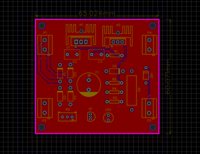

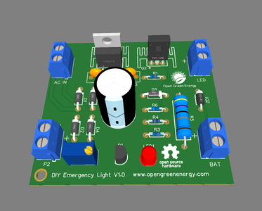

Step 3: PCB Design
I have drawn the schematic by using EasyEDA online software after that switched to the PCB layout. The user interface is very straightforward. I have just added all the components from the library and then connect them as per the design requirement.
After drawing the schematic, I switched to the PCB design environment, where all the components that you have added in the schematic should be there, stacked on top of each other, ready to be placed and routed.
Drag the components by grabbing on its pads. Then place it inside the rectangular borderline. Arrange all the components in such a way that the board occupies minimum space.
After that, I have added 4 mounting holes at the corners of the PCB so that it can be mounted in an enclosure.
The last part is routing, it is the most fun part of this entire PCB designing process. It’s like solving a puzzle! Using the tracking tool we need to connect all the components.
After spending an hour, I have completed the PCB design. I am really satisfied with the final outcome.

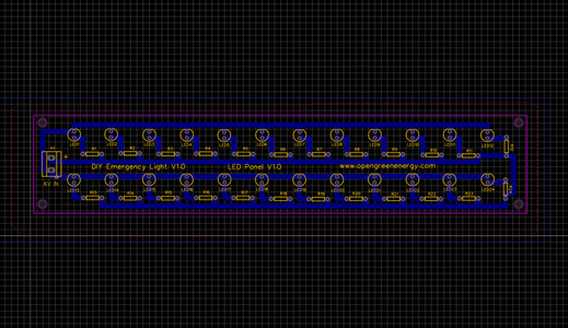

Step 6: LED Panel
You can either buy the 6V LED panel from the market or you can make it. Here I have made my own.
The LED panel is made up of 24 numbers of 4.8mm clear white straw hat LEDs. All the LEDs are connected in parallel with a 100-ohm resistor in series with each.
I have designed a PCB for the LED panel too, you can see the 3D image of my PCB in the above picture.
Download the Gerber file from here
Step 7: Assembling the LED Panel
First, I have to bend all the resistor's leg as shown above. Then I soldered them and trimmed the extra legs by using a nipper.
Before soldering the LED, check them by using a coin cell. Then insert all the LEDs into the PCB holes and secure them by using masking tape. The masking tape will hold all the LEDs in their place when you invert the PCB for soldering. Then solder the LEDs and remove the masking tape.
At last solder the screw terminal. Now the LED panel is ready.

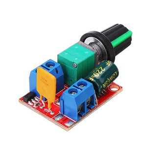

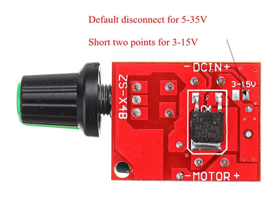

Step 10: Brightness Control
The LED brightness can be controlled by using a potentiometer or by using a dedicated PWM LED dimmer. In the first method, you'll be wasting a lot of energy in the form of heat. It's much more efficient to regulate brightness by using PWM ( Pulse Width Modulation ) method.
Here I have used a PWM LED dimmer that can handle up to 5A and its operating voltage range is 3V-35V. You can see the above picture.
The connection is very easy, the dimmer module has two terminals DC IN and Motor. The DC IN terminal is connected to the mainboard LED terminal and the Motor terminal is connected to the LED panel. During connection, be sure the polarity is correct. The polarity is indicated on the dimmer module as well as on the mainboard.
Now you can connect the battery at the battery terminal, and check the brightness by turning the LED dimmer knob. I have checked it, it works perfectly.
