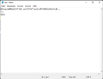

The last thing I want to point out is the way the starting point is calculated. In the program you can type in a number between 1 and 100. This number is then devided by two because we only have 41 numbers to choose a starting point from. So now is the highest number possible 50, which is still to high. To make the starting point even more random there is a random number created between 1 and 82. I took 82 because 41 is 82% of 50. Now the number is divided by 100 to get a 0. something number which is multiplied to the number typed in.
You still have to add the background as a file to Processing if you're using my code. It's the one above this step. To do this, go to sketch -> add file and select it. It should be called Background.png. Unfortunately I couldn't upload the exported program here because the file type is not supported but you can do it yourself if you go to file and then click on export. I attached the whole processing code below.
You can change how many lines you want to encrypt. Just be careful because the number you choose has to be the number you want to encrypt +1 because you also want to be able to decrypt your text at some point. The line you have to change is:
String[] textE = new String[200];
you can change 200 to what you want. Have fun!
