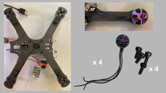

Step 1: Base Structure
Put sponge pads on the bottom of the carbon fiber frame. They will protect the drone when landing. Screw on the motors using small screws. Three wires from the motor should align with the frame.
Important: Check that the screws do not touch the motor (if it does, you picked the wrong length of screws.)
