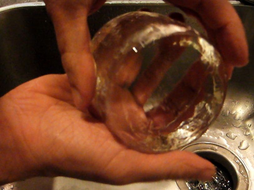

- A reflector. This part is optional--you can use it if you need a bit more directionality to your light. This one I got from Deal Extreme, part number 39963, "20~100W Silver Plated Plastic Smooth Reflector (58mm)", $2.10.
