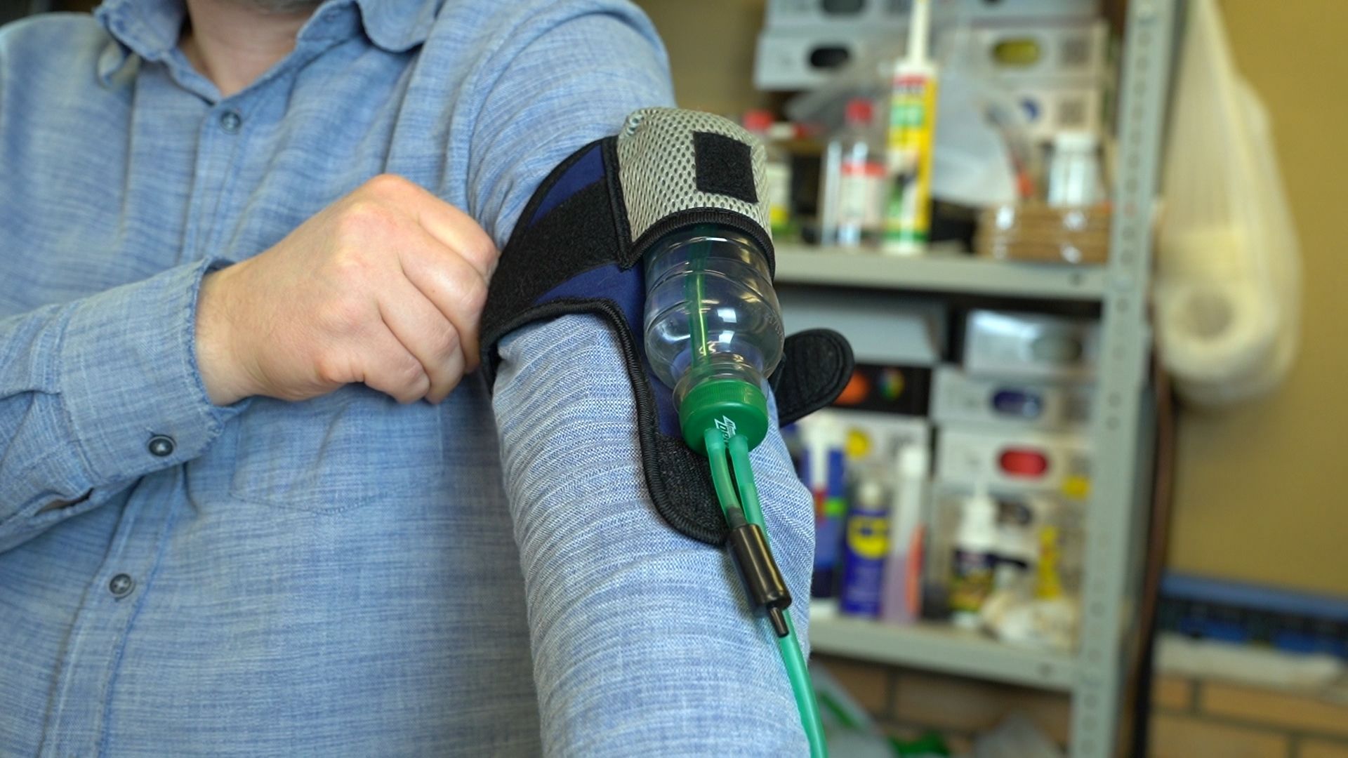

Step 12: Assembly of the Tank:
Drill 2 5.5mm holes in the cover.
Step 13:
Measure and cut the silicone tube of the right length (from shoulder to wrist). Also cut off two pieces of silicone tube, one for the check valve and one for the air inlet into the vessel (so that no vacuum is generated in the vessel).
Step 14:
Insert silicone tubes into the cover and fix them there with plastic connectors.
Step 15:
Install the check valve so that it allows air to flow in the direction of the cover.
Step 16:
Pour antiseptic into the bottle. Insert the bottle into the Sport Armband.
Individual hand sanitizer dispenser ready to go.
Step 17: Put On
Step 18: Using
When you press the knob, the antiseptic comes through the tube.
