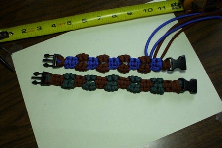

Introduction: How to Make an "Islands" Paracord Bracelet
Hi again! I have a new offering for you. Real simple but nice looking.
I call this model 'Islands'. I also make one with single side half knots and call it 'Shoulders'.
I hope you have fun with this one. It takes next to no time to make and is easy to adjust to different sizes.
(Part 12 talks about adjusting for size.)
You will need 2 colors of paracord, both aprox 4 1/2 ' long. You will also need a small plastic bracelet buckle, about 5/8" size will do.

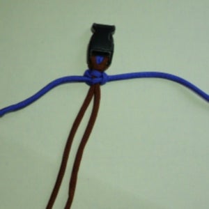

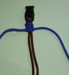

Step 1: Lets Get the Cords on the Buckle!
1) Start with 2 4 1/2' cords. Find the middle of both cords.
Start with the cord that will not be the 'Island' color.
Put the loop down through the top of one half of the buckle.
Bring the loop up and over the buckle and tighten it down.
Put the second color down the same way, and again bring it up and over the buckle.
In the picture I've spread the second cord out so you can see both operations.
1b) Tighten the second cord over the first. This is the top of the bracelet.

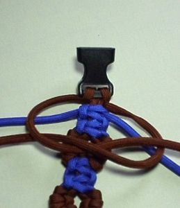

Step 2: Begin Your First Square Knot the 'right' Way!
2a) We are now going to take the first color and make square knots around the 'Island' color.
Bring the right cord over the core and place the left cord on top of it.
2b) Pass the left cord under the core...
2c) and 'up' out of the loop formed by the right cord.
See how the cords go over and under the core while making the square knot?

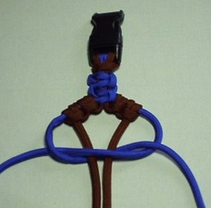

Step 3: Begining the Pattern...
2e,f,& g) Tighten up the knot and then do the same steps with the oposite cords...
lay the left over the core,
lay the right on top of it,
then pass the cord under the core...
and up through the loop formed by the left hand loop.
Tighten them up.
This completes one square knot around the core.
3) Repeat the process, and make a second full square knot. Tighten it down.

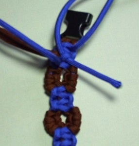

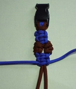

Step 4: Making the Islands.... Part One
4a - d) Lay your square knot ends out to the sides.
Now we are going to work with the core cords around each seperate side cord.
Bring one core cord up and over a side cord.
Pass the end under the side cord then up and over its own loop as shown.
Snug it up.
The end should be between the core cord and the body of the work..
4e) Now pass the same cord Under the side cord
and down through its own loop, snug it up.
This completes one half hitch set.

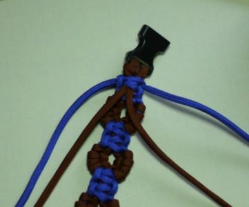

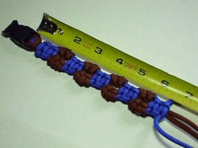

Step 7: Working the Patern
7a - b) Repeat the steps making more islands
until the desired length is about 1/2 - 3/4" short of the intended length.
This shows the intended length to be 7" and I have come out even!!! Wow!
This will not always be the case!
How to adjust it comes later....

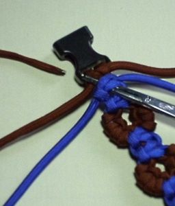

Step 8:
8a - f) Pass the core cords down through the other half of the buckle.
Bring them to the top and make half of a square knot
on top of and not around the core.
Turn over and make the second half of the square knot.

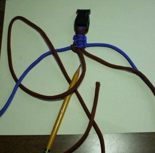

Step 9: Taking Care of the Ends.... Part One
9a - c) Pass the core cords down through the last square knot
of the outside color (here in blue).
Retighten the outside knot.
Step 10: Taking Care of the Ends.... Part Two
10 a&b) Pass the two outside color cords through their own knot
below the one just used.
11) Cut and singe the ends, and press against the ends while still hot, to smooth and seal them in place.

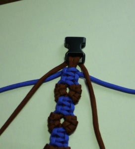

Step 11: Finished!
12) Finished!

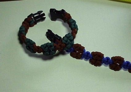

Step 12: Adjustments!
13) If you need a longer piece,
add an extra half double knot with the outside color, to one or both ends.
For a shorter one, subtract half a square knot from one or both ends.
13b) Here, (in the bottom green and brown) I have just brought the core cords through and tied the extra knot over them.
