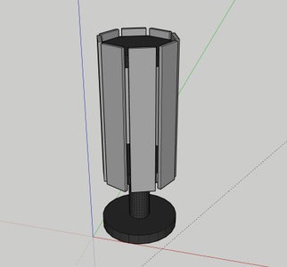

Cut 2 pieces of 1x6 to 5 1/2" long to make a square. Then mark out a 5 1/2" octagon on one piece and cut the corners where marked at 45 degrees. All the sides should be the same length. Now, trace that shape on to the next piece and cut out a matching piece.
Using your 1 1/2" forstner bit, drill about half way though the center of one of the pieces. Now take that same piece and cut 4 slots on the opposite side of the hole and perpendicular to each side (See image). These slots should be wide and deep enough to fit the LED wires in.

Using a piece of 1 1/2" dowel, cut to the desired lamp height. I cut mine to 5". The longer it is, the harder it will be to drill a hole through for the wiring.
Now assemble the dowel to the base and bottom frame piece using wood glue and clamps. Make sure everything is square and adjust the clamps if it is not.
Finally, drill a hole all the way though the post to run the wire.

Using 1/4" plywood cut 8 2" x 8" pieces.
