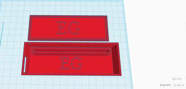

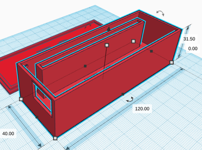

Step 3: Designing and Printing the Box

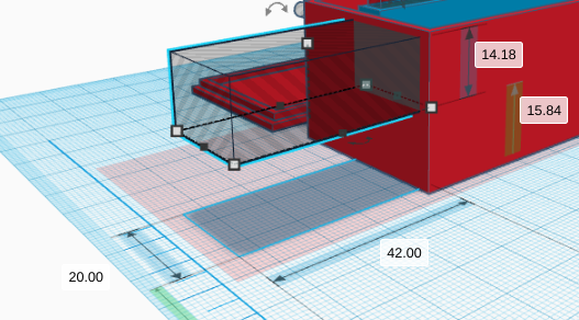

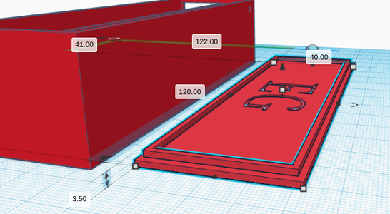

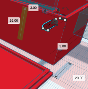

For this step, you will now go to TinkerCad and create a box with a lid and a slot for your Acrylic, Wires, and switch. Once you have TinkerCad opened, sign up or create a new account, then you will now click on 3D Designs, Click on Create New Design. Now you have a workspace to work on. Drag the Ruler into your workspace after that Drag a Box to your workspace. Click on the Box, it will show you the Numbers on the X, Y, Z points. Make your X= 120.00, Y= 40.00, and your Z= 31.50. Now Drag a non-colored box, which should be on top of the red box. Drag it to your workspace, click on it and make it X= 117.00, Y= 37.00, and Z= 33.00. Group them together! Now Create your side slot for your I/O switch. Drag another clear box to your design, make the dimensions, X= 42.00, Y= 20.00, Z= 14.18, and the height= 15.84. Make the slot go on the left side of the box and to the top right and group it. For the wires, grab a Clear cylinder, Make the cylinder flat on the board, make the dimensions X= 3.00, Y= 3.00, Z= 20.00, and the height= 26.00. Leave it behind your box, but next to your switch, there is a photo up top if you need help, then group it. Once you are finished with the Slot, you will now make the slot for your acrylic. For this, you will need a box with dimensions of X= 100.00, Y= 7.00, and Z= 30.00. Align it to the middle of your box and press the "Up" arrow 10 times. Now drag a clear box with dimensions of X= 97.00, Y= 4.00, and Z= 40.00. Make this clear box fit in the middle of the Acrylic box you made and group it together, there is a picture up top if need the help of use for help. Once that is done and grouped together, make the lid of your box. Drag a box to your workspace to make X= 120.00, Y= 40.00, and Z= 1.50. Now drag another box of dimensions of X= 117.00, Y= 37.00, and Z= 1.50, with a height of 2.00. Group and align them together! Now grab a clear box with dimensions of X= 114.00, Y= 34.00, Z= 20.00, and a height of 2.00, Align and group them together. Now you have your box and lid ready for printing. Click on the lid and go press "Export," click on the "STL" file. Save it! Now click on your box and do the same as you did with the lid. Go ahead and print those files on your 3D printer. Now let's move on to the other step.
