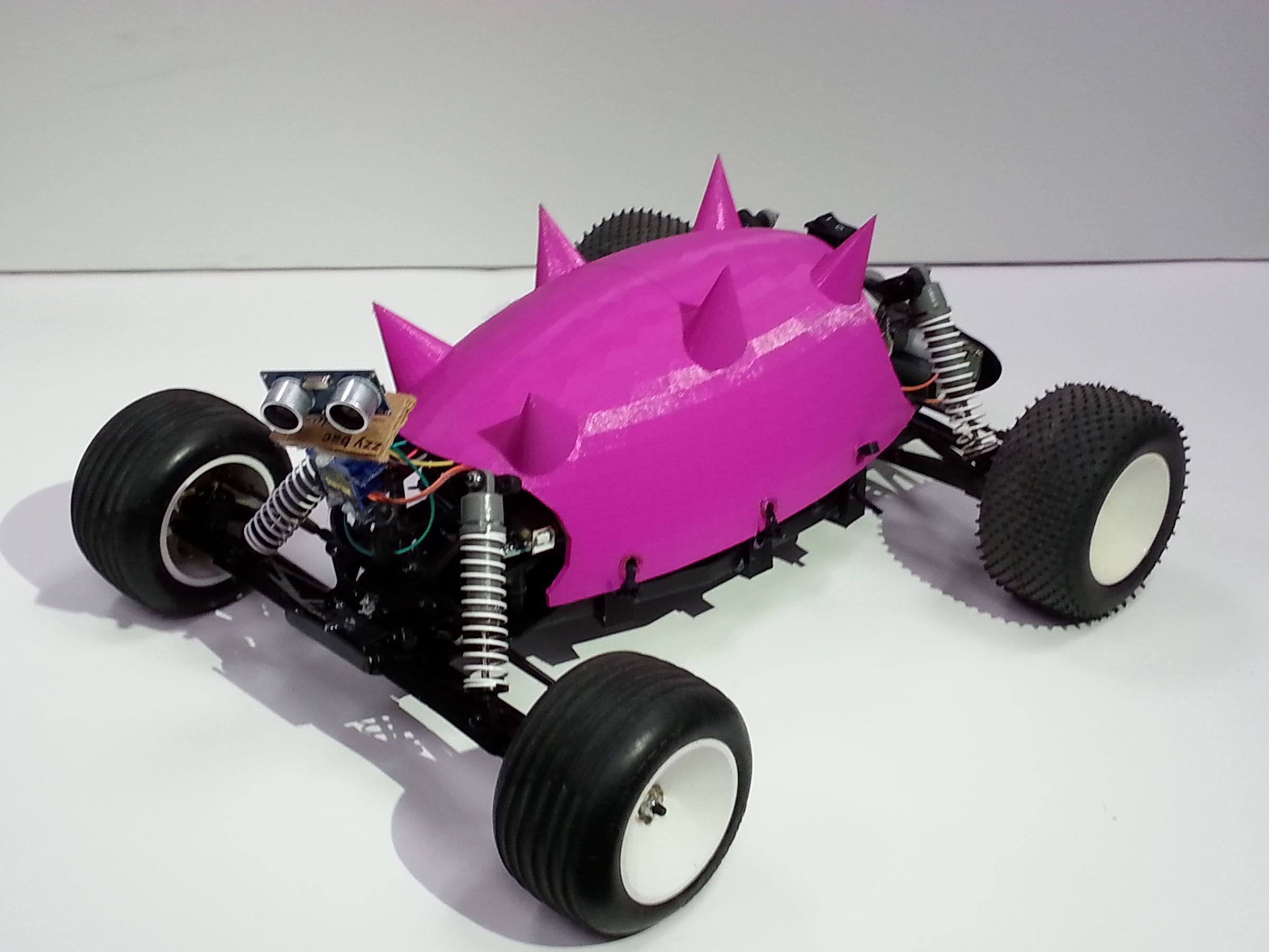

His name is Eisseb (see what we did there). Eisseb is our obstacle avoiding car. He began as a fancy RC car chassis, and with some modifications, plus an arduino uno and a sonic sensor, he became what he is today: awesome.

Step 8: Optional 3D Printed Shell
This step is not necessary but it totally looks cool. I made a turtle shell for our autonomous robot to keep all of the wires and stuff safe inside while also looking pretty awesome as it drove down the hallways of our school. It's a simple design that I made in Tinkercad. Tinkercad is a web browser based simplified 3D modeler.
In Tinkercad all I did was make an oval and some cones to make the spikes, I then measured it out to fit our car and printed it out on our 3D printer. The files are available for you to use, the program is super simple and you are more than able to take the design and make it your own.
*We needed to also print out brackets to attach the shell to the sides of the car via zip ties.*
