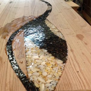

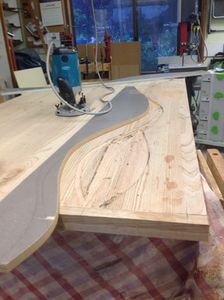

Over the past five years I had used casting resin and sea shells in jewellery boxes. I decided that the poor join in one of the table top pieces could be enhanced by inserting a shape with a router and filling it with resin and sea shells. The first attempt at this produced a result that I was very unhappy with it and I then decided to make a template that could be used with a router that would run the length of the table top shaped like a river or a snake. I removed the casting resin and shells from the first attempt with a great deal of difficulty and designed an MDF template to guide the router as shown in the image.
Step 2: Adding the Stones

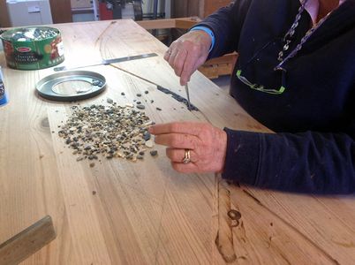

My wife Robyn began the process of inserting black and white stones that I collected from a beach in New Zealand.

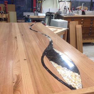

The next step was to pour the casting resin on top of the stones which takes about 5 to 7 days to harden. Once hardened it can be sanded and the result was very pleasing. Other holes in table top were also filled with casting resin and sea shells. The resin was poured so that it sat proud of the routed out shape and was subsequently sanded using 60 to 3000 grit. Below you can see the result resin unsanded (left) and sanded. I was happy with the outcome.

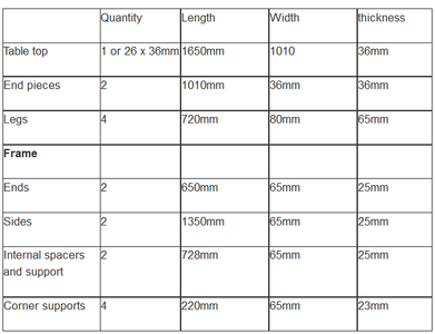

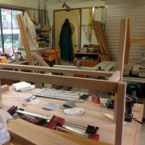

The wood to make the table frame and the legs all had to be laminated as the available wood after dimensioning was not of sufficient thickness. In order to make a sturdy leg each leg had to be laminated give an 80mm by 65mm dimension. Each of the frame pieces also had be laminated into the dimensions outlined in the attached image.
The frame was then joined using a Festool domino machine. Whilst I had become very efficient at laminating wood I was using far more of the wood than I have anticipated. Before I glued the frame together I decided that because this table was heavy and would be moved around an outdoor deck frequently it would be better on wheels for ease of movement.

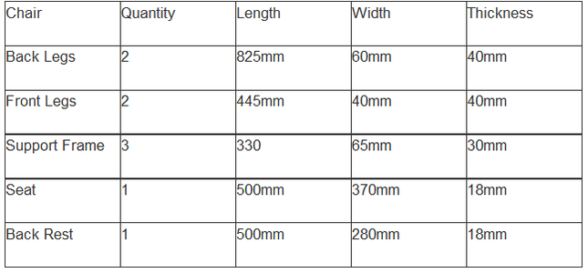

The only piece of the entire structure that did not require pieces to be laminated were the chair and bench legs. The photo shows how the chairs were assembled.

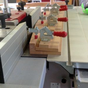

I could not shape the seat or the back of the chairs because I did not have sufficient wood of the quality that was required. The seat and back had to be flat. Given that this was an outdoor setting the legs had to be substantial as they are going to get wet sooner or later. So I designed a back leg profile that was straight and was not thinned at the bottom. I made a template for the legs using MDF and shaped them using my spindle moulder.
The seats and backs of were all joined using the last available pieces. However I did not have enough pieces for the back and seats of the bench of the same length to have a rectangular back and seat. The next design opportunity was to shape the seat and backs with a diagonal cut so that I could use the small lengths with large ones. At the end I had one piece of wood left!
See attached image for chair dimensions.

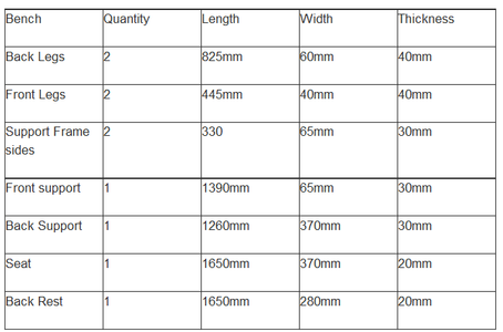

Step 5: The Benches
The side benches were only a larger form of the chairs. The same technique and structure were used for the two side benches.
See attached image for dimensions.

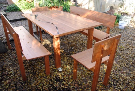

Step 6: The Result
It is functional and comfortable and my family thinks it looks great! I decided to finish the table and chairs with Sandolin Hardwood Oil. I had never used this product before but I chose it because of its water and weather resistance qualities. It also gave a clear natural finish.
