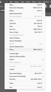

Step 2: Insert Image: File -> Place

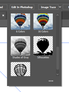

Step 4: Choose One of the Images and Perform an Image Trace
Step 5: Expand the Traced Image

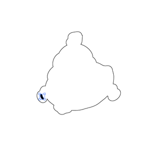

Step 8: Create Offset Path: Object -> Path -> Offset Path
Step 9: Flip the Fill and Stroke of the Image to Get the Outline
Step 10: Ungroup Path and Delete Unnecessary Strokes

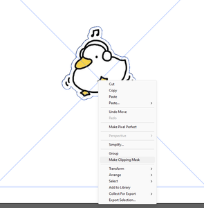

Step 13: Select Both the Image and Path and Create a Clipping Mask
Step 14: Drag the Second Offset Path Over the Clipped Image and Group Together
