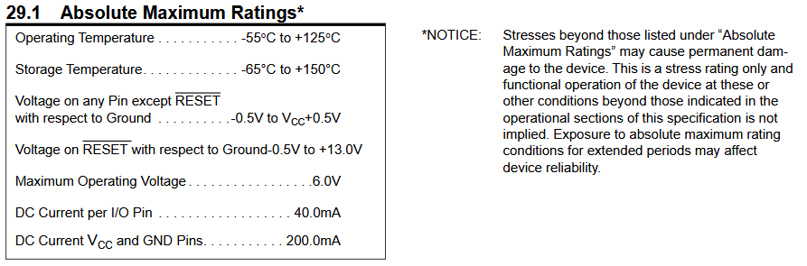

Arduino Uno’s ATmega328P Absolute Max Ratings
Before we get started with anything for this part of the build, we first need to go over the Arduino Uno’s ATmega328P microcontroller, and its absolute maximum ratings to gain an understanding of what we need to do to hook up our components properly to prevent damage to the Arduino Uno and its microcontroller.
If we take a look at the table above, we see that the values within it are the absolute maximum ratings for the I/O (Input/Output) pins of the Arduino Uno’s ATmega328P microcontroller.
Looking at the values above, we can determine what we’re limited to, based on the microcontroller’s ratings. What we want to focus on are the following:
  1. DC Current per I/O Pin: 40mA
  2. DC Current VCC and GND Pins: 200mA
The datasheet is telling us that the DC current from each of the I/O pins, both analog and digital of the Arduino, is limited to 40mA. The DC current of the VCC and ground (GND) pins are limited to 200mA. The datasheet also states that stresses beyond these listed ratings may cause permanent damage to the device.
