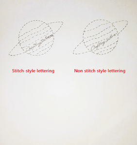

Step 1: Designing the Logo on Paper
We took paper and pencil, and we started to make different logo prototypes.
We will decide on the design we want to digitalize.
In my case I want to make a logo of the planet Saturn, made as in sewing stitches, and with my nickname written in the middle. So I had to:
  1. Make a circle, and a curved line representing the ring of Saturn; the idea is not to over saturate either, but to make a simplified idea of the planet.
  2. In the middle of the planet, the nickname written in a curved form as if it were a continuation of the rings passing through Saturn. The choices were between two base options, one with the title written as stitches, and one without.
  3. And make several lines that cross the planet.

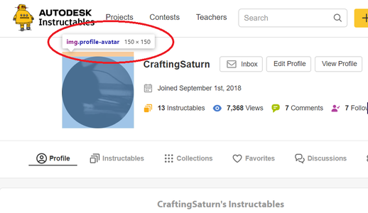

First, we see what file characteristics Instructables supports as a profile picture; that it is 150x150px. (Using "Inspect web element" on profile image).

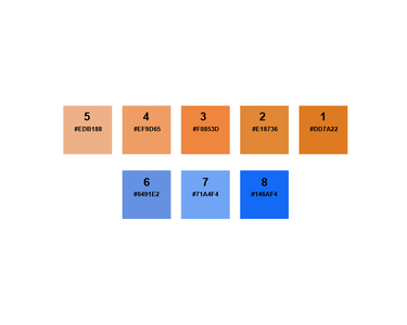

Step 4: Choosing a Color Palette
On the Internet you can find different color palettes with which the planet Saturn is identified.
You can take these free color palettes as a reference or you can take a different color variant yourself.
I will take 5 colors within the orange shades, since the palette of colors that can be obtained from images provided by NASA of the planet saturn, are within the pale green and earth shades, but for my logo I want more vivid colors.
For the lettering, I will take shades of blue, as it contrasts with the orange tones.
These shades of colors in web colors code, are:
  • Orange tones:
#DD7A22, #E18736, #F0853D, #EF9D65, #EDB188
  • Blue shades:
#146AF4, #71A4F4, #6491E2

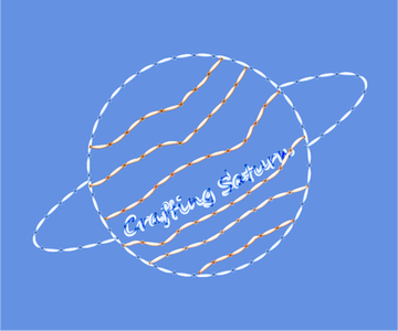

Step 5: Making the Logo Design Base
  1. We make a 100 px circle with the Ellipse tool and align the circle.
  2. We make an ellipse of any size with the ellipse tool.
  3. Then, with the ellipse selected, click on Transform and change its angle to 30 degrees. Hit enter.
  4. Click on Transform again, this time we change the size of the ellipse to W: 150px, and H: 80 px.
  5. Cut segments that cross between the ellipse and the circle. Use the Scissors tool
  6. Delete one of the lines we just cut, the one behind the planet.
  7. Use type on a path tool on the other available segmented line.
  8. Type user name or logo text.
  9. Drag text position line on the center to flip text.
Step 6: Making Detail Lines of the Logo (planet)
  1. With Curvature tool, make freehand lines that simulate the shades of the planet.
  2. Then, use the warp tool to make the lines not so clean. This will help the stitch brush look more natural.
  3. Double click on warp tool, and give the following settings to the warp brush circle: W: 20px, H: 20px.
  4. Hold down the right click while passing the circle through the inner curved lines of the planet.
Step 7: Applying Brush Patterns to Lines
Change logo text settings to be able to apply the brush style:
  1. We can change the font before doing this step.
  2. Select the text and click on Expand.
  3. Select a stroke color.
  4. With the text selected, click on Paintbrush tool.
  5. Go to the brushes tab and select the stitching brush we made in step 3.
  6. We apply the brush as a contour of the letters.
  7. Now we proceed to apply the brush to the rest of the lines of the planet.
Step 8: Applying Color to the Lines
Select the lines made in the previous step and with the Eyedropper tool, select the stitching color with the color of your choice.
  1. First we select a stroke
  2. Then the Eyedropper tool,
  3. Finally we select the color.
Remember to change from fill to stroke, after selecting the color.
