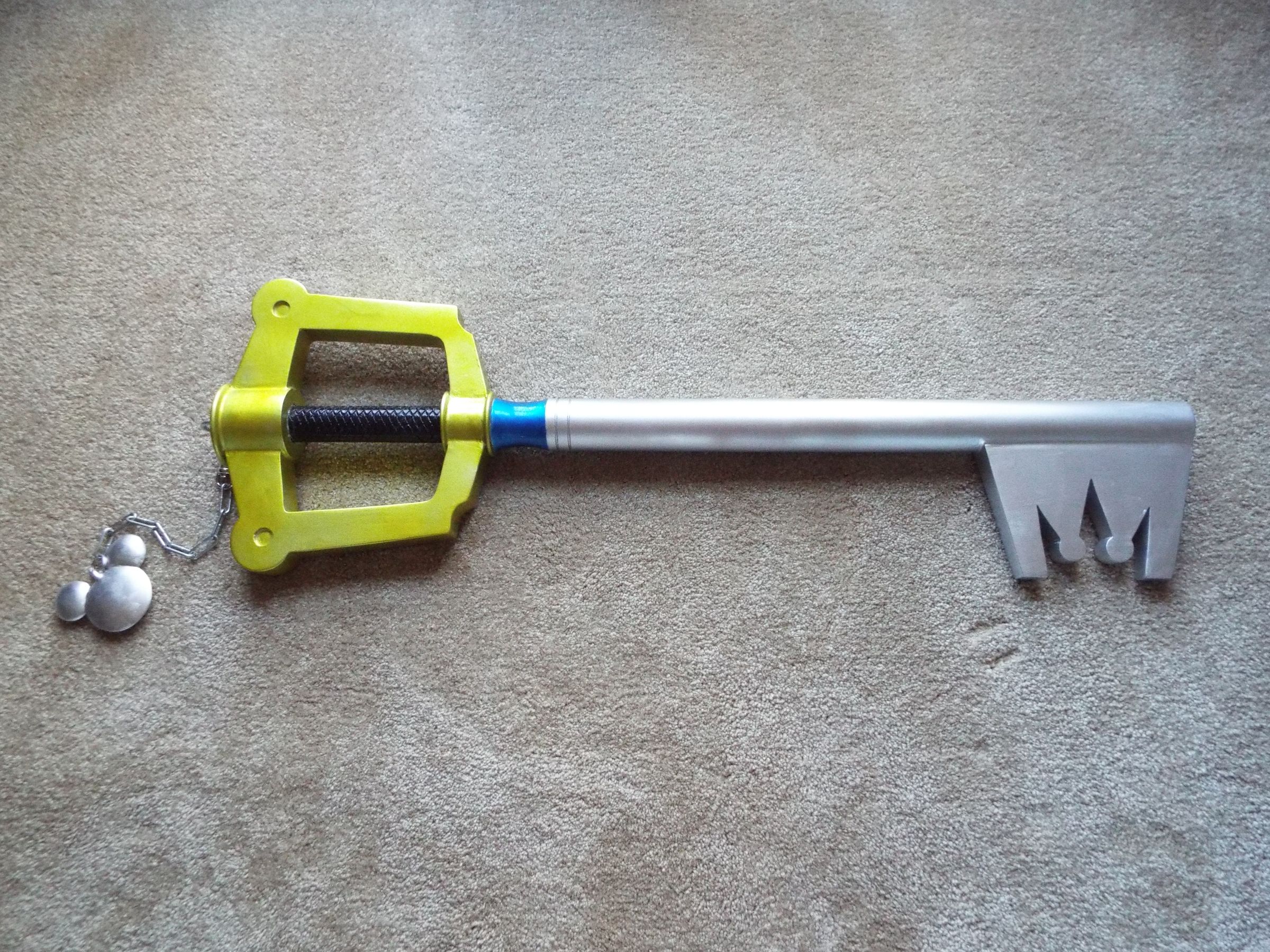

Step 9: Finished!
We've reached the end of the tutorial. The outcome is rather nice, and it doesn't even need a coat of gloss.
Specs: 75 1/4 inches long; about 3 ft wide; 3 inches at thickest; 15 pounds (top-heaviness makes it feel like 30)
The keychain was made by making two 2.5 inch long keyblades, making a recess in the heart shape, gluing, bondo, sanding, and painting. Straight steel chain 10 was used with 2 snap hooks.
