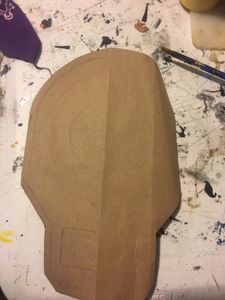

Step 8: Optional: Thigh Armor
1. I made these thigh pieces in the same way i made the shins (a front plate and a back plate). I liked the concept, but later realized it created a pretty boxy look to my feminine rendition of our character. If i went back to the armor idea, then i would consider making these thigh pieces more form fitting.
2. Measure the front of your thigh and the width you would like. Transfer to folded paper, draw out your design, cut out, and unfold to get your symmetrical paper template. Transfer to EVA foam. (pic 1)
3. Use the same method and create the back plate of EVA foam. (pic 1)
4. Glue the thigh pieces together and make sure they fit comfortably around your thigh.
5. I then used EVA foam to create a double set of straps that wrap around the thigh. Heat the straps with your heat gun to make the straps more malleable (pic 2)
6. cut your border in using your exacto knife and heat them with the heat gun to accentuate the lines (pic 3)
7. don't forget to add the strap tabs (pic 4).
