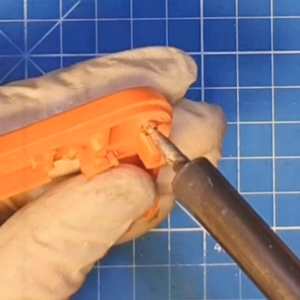

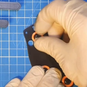

Using a soldering iron or a pyrography tool, heat the injection nuts and insert them into the corresponding holes applying slight pressure. Make sure not to use temperatures that are too high, otherwise, you risk excessively enlarging the hole; 250°C should be sufficient.
If excessive dilation occurs, correct the error using two-component epoxy glue or putty.
Insert the square snap-in nuts M3 5.5x5.5x2 into their respective slots in the bases.
In the STL archive, there is a PDF file with the dimensions of the nuts and screws used. Some of these dimensions are indicated in the captions.

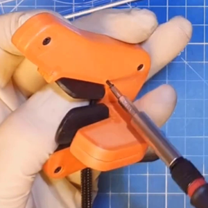

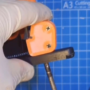

Secure the two parts composing the thumb base with countersunk head screws. Then, attach all finger bases to the main base using round head screws.

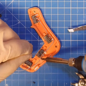

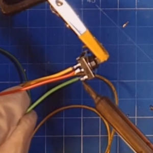

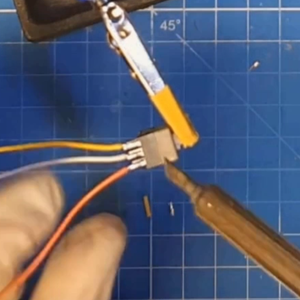

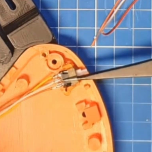

Step 5: ASSEMBLE THE MICROSWITCHES
Insert the microswitches while respecting the orientation shown in the photos to ensure proper contact with the finger levers.
For the electrical connections, use a black wire for the ground (GND) and solder the wire connecting all the common (C) pins. Leave about 20 cm of wire outward for connections to the GND board.
Use four separate wires with different colors for the normally open (NO) pins. Leave about 20 cm of wire outward for connections to the microcontroller. Make sure to use the same wire color for all fingers to avoid confusion with connections.

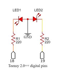

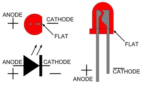

Step 6: ASSEMBLE THE LED DIODES
WIRING DIAGRAM⚡
Bend the LED diode cathodes into an L shape and solder them together, fixing them at a relative distance to match the holes in the orange box.
Next, solder a 220 Ohm resistor for each anode as indicated in the diagram.
Solder two wires of different colors to the two resistors and a black wire to the junction of the LED diode cathodes. This wire will be connected later to the GND.
Finally, protect the exposed parts with heat shrink tubing.

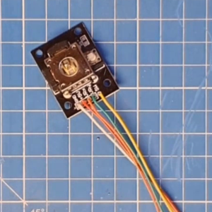

Use colored wires as desired for the Joystick, the Multidirectional Switch, and the Button.
Next, test the switch outputs (up, down, right, left, and button) with a multimeter and note the correspondence with the wire colors. If available, consult the datasheets for further details.
Remember that the center pin of the toggle switch corresponds to GND.

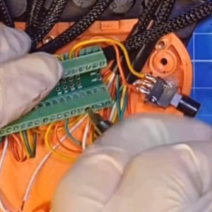

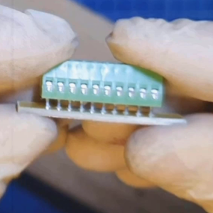

Step 8: PREPARE THE TEENSY 2.0++

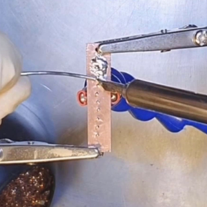

Insert the terminal blocks onto the Teensy 2.0++ and solder the pins following the orientation shown in the photos. Keep the board against a flat surface during soldering to ensure that the terminal blocks are well aligned.
For the GND terminal block, you can use a stripboard or a copper board to be cut and drilled as indicated in the photos. Make sure to take measurements from the "main-base.pdf" document provided in the archive. Then, solder all the pins together. This terminal block will be used to connect all the negative wires from the various switches.

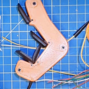

Step 9: ASSEMBLE THE TOWERS AND LEVERS

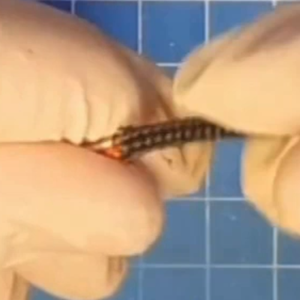

Insert the wires into the PET protective braid, previously finished at the ends with a soldering iron or a lighter.

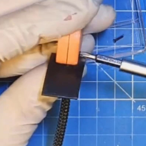

Close the towers with the screws indicated in the image, making sure to also insert the PET protective braid inside. For the index tower, assemble the additional button first and then proceed with closing the tower as described above.
Apply about 15 mm of heat shrink tubing to the end of the protective braid towards the Teensy board.

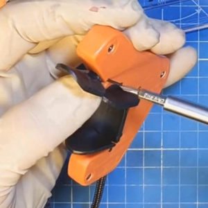

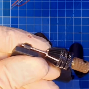

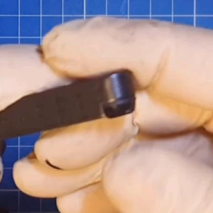

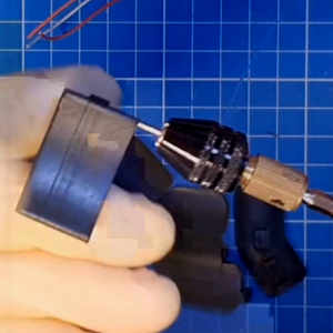

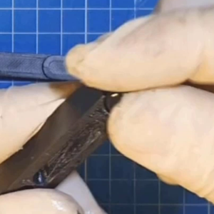

Uniform the holes of the levers using a 1.5 mm diameter drill bit and file the side parts near the holes.
Ensure that the levers can move freely in their housing without friction. Perform tests to understand how much filing is needed, as this depends on the quality of the 3D print.
Assemble all levers into their respective housings and use the screws indicated in the image caption, or refer to the "NutScrewSizes.pdf" document in the archive.

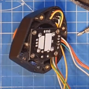

Step 10: ASSEMBLE THE JOYSTICK
Carefully file the housing for the multidirectional switch so that it is not overly tight. If you need to remove the switch later, it may be difficult to pull it out.
Next, insert the multidirectional switch and the analog joystick into their respective housings as shown in the photos.
Organize the wires and insert the PET protective braid.
Close with the cap using the indicated screws.
Finally, insert the snap-in lever for the multidirectional switch.

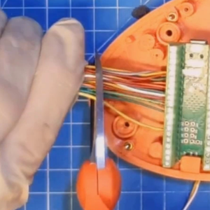

Step 12: CONNECT THE ELECTRONICS
Group the cables and cut them near the end of the base, following what is shown in the photos.
Next, prepare the ends of the wires by stripping about 4 mm of wire and applying a bit of solder to make the connection more secure in the terminal block.
Insert the bistable switch and secure it with some hot glue, being careful not to use too much to avoid melting the PLA.
Finally, connect the GND board with the M1.4X5 screws.
Connect the USB cable and use the terminal block to secure the Teensy to the base.

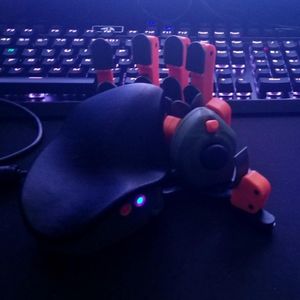

Connect the keypad to a USB port on the PC and check if the electronics work. At this time, it is not possible to fully use the keypad before flashing the Teensy 2.0++ board. However, it is important to check for inputs and if the lights turn on.
