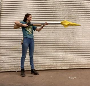

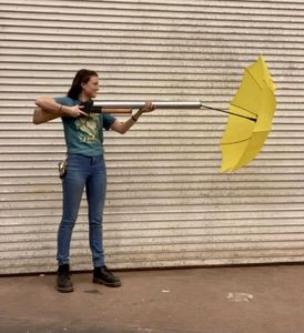

Note: This umbrella was successfully fired over 30 times. However, for long-term use, I recommend using a stronger material than PLA for the stopper, as repeated impact will eventually degrade the PLA.

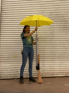

Sourcing Umbrella: When sourcing an umbrella, there are several things to look for. First, look for one with a plastic hook and one that has the closing mechanism at the bottom of its shaft, not a push button on the handle. The umbrella should also be auto-opening but not collapsing.
Umbrellas with hooks typically have a hollow shaft, making it easier to modify the umbrella to fit onto a rod. An umbrella with a button on its handle, makes it much harder to remove the bottom and the closing mechanism. Additionally, an auto-opening umbrella is required as, once the closing mechanism is removed, it naturally remains open. This means it will only stay closed when inside the "barrel" and will open once it pops out. Furthermore, we want an umbrella that doesn't collapse, as this would make it harder to make it come out from the barrel.

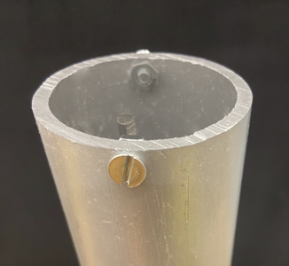

- At the opposite end of your PVC, drill two small holes on opposite sides of each other to fit your half inch ³⁄₁₆" bolts.
- These bolts will be used to prevent the stopper from exiting the barrel.

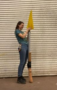

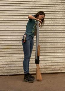

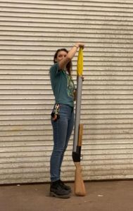

- Take the umbrella and slide it onto the rod, inside the barrel.
- Take your two bolts and place them in their respective holes at the end of the barrel and secure them with nuts.
- Push the umbrella back until it clicks behind the lever.
- The next time you release the trigger, the umbrella should shoot out of the barrel!
