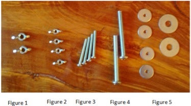

• Two square feet of ¾- inch MDF board
• Saw
• Hand drill or drill press
• Four- 1/8 – by 1 ½ inch bolts (Figure 3)
• Four- 1/8-inch wing nuts (Figure 2)
• Four- 1/8-inch washers (Figure 5)
• Two- ¼-inch wing nuts (Figure 1)
• Two- ¼-inch washers (Figure 5)
• Two- ¼ by 3-inch bolts (Figure 4)

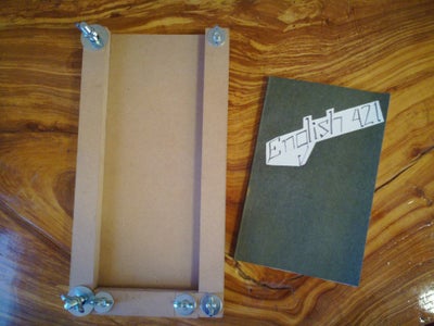

Step 3: Manufacturing Instructions

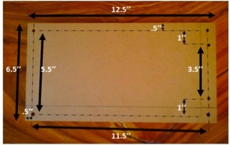

Cut a 12 ½ by 6 ½ inch section of board using the saw. (Be sure to use proper safety when operating the saw. Refer to the safety information above.)
Step 4: Manufacturing Instructions

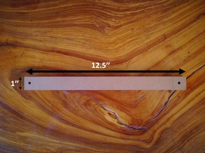

Cut two 12 ½ by 1 inch brackets from a new piece of MDF board.
One will be the alignment bracket and the other will be the clamping bracket.
Step 5: Manufacturing Instructions

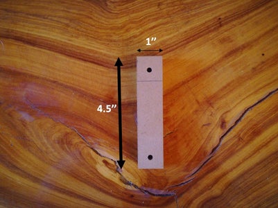

Cut one 4 ½ by 1 inch bracket from a new piece of MDF board. This will be the side alignment bracket.
Step 6: Manufacturing Instructions
Position the alignment and clamping brackets flush with the edge of the board. Secure each with a C-clamp, or anything else that ensures the bracket will not move, before drilling the holes for the attachment bolts.
Step 7: Manufacturing Instructions
Drill two- ¼ inch holes through the board and brackets. Ensure that the brackets do not move out of place while drilling so that the holes are aligned and straight. (Be sure to use proper safety when operating the hand drill or drill press. Refer to page 2 for safety information.)
Note: After the ¼ inch holes are drilled in the clamping bracket, get a slightly lager diameter drill bit and drill through the same holes. The larger diameter holes will allow the bracket to slide and adjust to the edge of the board when clamping the pages.
Step 8: Assembly Instructions
Attach the bottom alignment bracket to the main board by inserting two 1/8-inch bolts through the pre-drilled holes.
Step 9: Assembly Instructions
Slide the 1/8 inch washers onto the bolts, and then tighten the 1/8 inch wing nut on the bolts.
Step 10: Assembly Instructions
Attach the side alignment bracket to the main board using the same method used to attach the bottom alignment bracket.
Step 11: Assembly Instructions
Use the carpenter’s square to check for proper alignment
Step 12: Assembly Instructions
Attach the clamping bracket using the same method used to attach the bottom and side alignment brackets.
Use ¼ by 3-inch bolts, ¼ inch wing nuts, and ¼ inch washers.

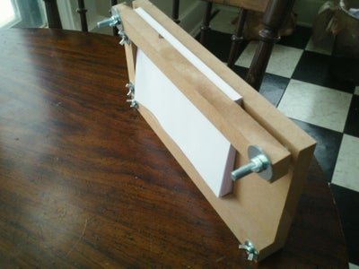

Step 13: Creating the Book
Take one sheet of the 8 ½ by 11 inch paper and fold it in half.
Step 14: Creating the Book
Fold however many sheets you would like to put into the book.
Step 15: Creating the Book
Place the pages into the book binding jig, with the folded edges at the top. This requires the removal of the clamping bracket to allow the pages to fit
Step 16: Creating the Book
The folded edges should stick out from the edge of the jig just enough to allow glue to seep in between them.
Step 17: Creating the Book
Make sure the pages are lined up with the alignment boards.
Step 18: Creating the Book

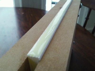

Slide the clamp down and tighten the bolts to press the pages together. This will become the bound edge of the book.
Step 19: Creating the Book
Apply the glue to the top of the folded pages. Do not oversaturate the paper with glue, but allow glue to seep an 1/8 inch in between the pages.
Step 20: Creating the Book
Allow the glue to dry for several hours.
Step 21: Creating the Book
Cut out an 8 ½ by 13 inch of paper (preferably a thicker paper than the book pages) that will be used as the cover.
Step 22: Creating the Book
Place the cover for the book (the 8 1/2 by 13 inch paper) into the jig, underneath the clamping bracket.
Step 23: Creating the Book
Apply a small amount of glue to where the cover meets the glued pages. Fold the cover page over the glued folded pages and press the cover page down.
Step 24: Creating the Book
After the glue is dry it can be removed from the jig.

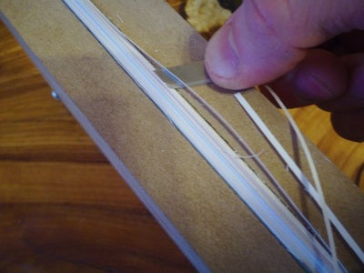

Trim the sides of book with an X-Acto knife and ruler to ensure flush edges.
