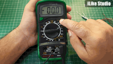

Every basic multimeter has a millivolt measuring feature through this we can measure very small voltage with high accuracy. So let's continue with this approach.

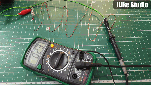

I am using a 20 SWG 1.2meter copper enameled wire, after setting all the parameters it gives the resistance value of 30milli ohms per meter.
This is the value of conductor at room temperature further increase in temperature increase the resistance of wire. Due to unwanted collision of the electrons.
Step 4: Theoretical Approach :
According to the OHM’s law, keeping the current constant and a small voltage drop take place in the wire, this can be accurately measured in millivolts by multimeter. Now divide that voltage by the current and we get the resistance.
Consider a wire of length 1.2 meters, let 1ampere is flowing through it. If the voltage drop across it is equal to 30milli volts then by applying V=IR
V= 30 millivolt, I= 1Ampere, R=?
R=V/I which gives the vale of R= 30 milliohms.
1 ampere is quite a large current, can be maintained using constant current power supply. But same can be measured using 0.1ampere. here I am using 1 ampere only for calculations simplicity. You can see, considering the voltage 30millivolts gives the value almost equal as calculated in online meter.

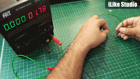

When we directly short the copper wire with 1 ampere power supply the voltage drops to zero, even the most stable power supply can’t provide the good result.

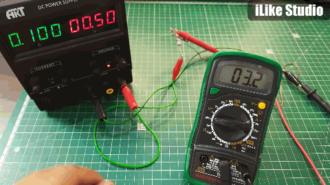

So, I connected 2 resistors of 10ohms(2watt) in parallel and then in series with the wire.
Now if we apply 0.1 ampere to the wire with resistors and the voltage drop is across the full length of 1.2 meter is 3.2 milliohms.
When OHMs law applied: V=3 milliohms, I=1 Ampere, R=?
R=V/I gives the value 30milliohms.

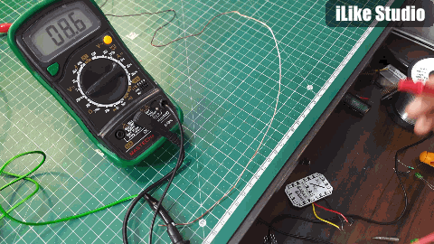

To precisely measure the value more readings can be taken by increasing the current to 0.2amperes, 0.3ampers ….
After measuring 2-3 values we can mean the value and can get the particle value of resistance of a wire.
