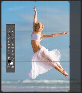

Step 2: Crop Image in Photoshop
Use the Crop Tool (C) to crop the image from where you want the mirror effect to start.
If you want a non-destructive mirror image effect you can use a Clipping Mask instead of the cropping image method, but it's more complicated.

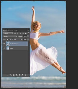

Step 3: Duplicate Layer in Photoshop
To create the mirroring image effect we need to have a copy of the original image. So, press Control+J to Duplicate Layer in Photoshop.
If you want to reuse this template for other images, convert the image to Smart Object before duplicating it.
