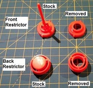

Step 2: Air Restictor
Next up, let's talk about the air restrictor. The air restrictor is a small piece of plastic inside the blaster that limits the amount of air that can flow through the barrel. Removing it will allow more air to flow through, which will increase the power of your shots. To remove the air restrictor in your Firestrike, you will need to open up the blaster and locate the piece of plastic that is restricting the airflow. It is located in between the barrel and the plunger tube. Use pliers or a screwdriver to carefully remove the air restrictor without damaging the blaster. Once it's removed, put the blaster back together and test it out.
