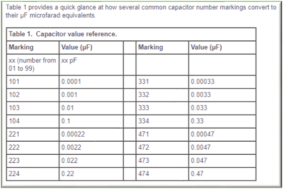

This table is shows what we should expect for some of these capacitors:
*Found at this website
Step 12: Measuring Capacitors - 10 Nanofarad Ceramic Capacitor
Using this nanofarad to microfarad converter, and the previous table, we should find this capacitor labeled "103" to be measuring at around 0.01 μF == 10 nF.
