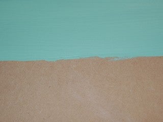

Step 1: First Color
Lay down the first color, extending past the area where the line will be. If you are using two layers per color, paint both layers.

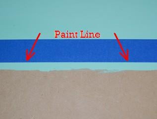

Step 2: Taping
Once the paint is dry, place your masking tape. In this case, the bottom of the masking tape marks the location where the edge between the two colors will appear.

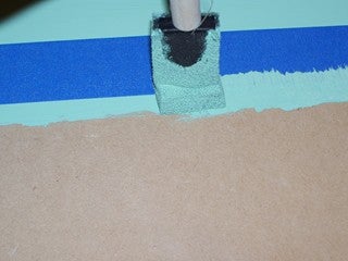

Step 3: Bleed Line
Using the same color, paint along the tape edge. This seems strange but, there will always be some bleeding under the tape. By deliberately painting against the tape, you seal the edge with the first color, allowing it to bleed under the edge, so the second color can't do it. The edge of the tape becomes the edge of your line.
Make sure the lower edge of the paint feathers softly away so you won't see a thick edge of paint later on.

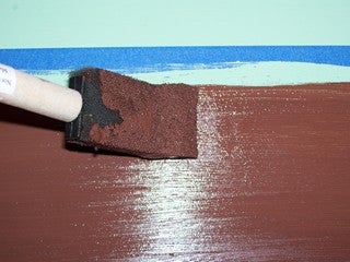

Step 4: Second Color
When the bleed-under layer has dried, paint the second color. Make sure your paint overlaps the location of the tape line.
