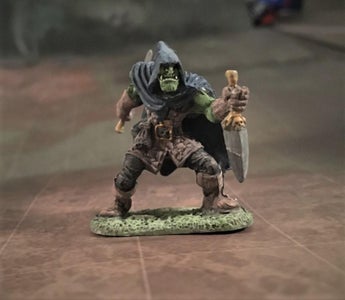

First, you'll want to block out the base color of each part of the miniature starting with the deepest level and working outwards. Most often the skin will be the deepest level with clothes being on top of that and accessories last. It's important to paint in thin layers so you don't lose the details of the sculpture under thick coats of paint. And it's okay to be a little rough with this first base coat of paint and to touch up the sloppy bits as you work outwards.
Note: I like to use miniatures that come primed and ready to paint. If your miniature is not pre-primed, you'll need to spray it with a coat of primer and let it dry before starting to paint.
Step 4: Dark Wash
Right now, the paint job looks a little flat. But that's going to change once we add a wash. A wash is thinned out paint that will pool into creases of the miniature creating shadows and contrast. You can buy ready-to-use washes specifically made for painting miniatures. I've made my own by diluting black acrylic paint in water. After your base coat is dry, you'll want to brush the wash over your entire miniature making sure the pigment gets into the creases and details.
Step 5: Drybrush Highlights
After the wash has dried, your miniature is probably looking kind of dark. No worries - we're about to use dry brushing to add highlights and more contrast! Dry brushing is a technique that uses a brush that has had most of the wet paint removed but still holds some pigment. Dip your brush in the same paint you used on the base coat for an area of the miniature. Brush some of the paint off onto a paper towel so your brush is more "dry". Then, lightly brush across the high points and details of the miniature to create a highlight.
After that first layer of highlight has dried, I like to go back to my palette of base colors and add just a bit of white to each color to lighten it and do another round of dry brushing to add even more contrast.
Step 6: Base and Details
Now, all that's left to paint are any small details that need touched up. And don't forget to paint the base the miniature is standing on too.
Your miniature is now tabletop ready!
