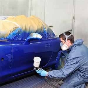

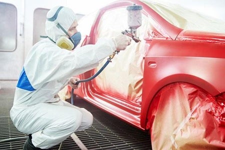

Step 6: Painting the Car

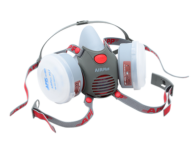

Now, your area has been wetted down, you have rolled the car back into the garage, put on the wheel covers, closed the door, turned on the lights, started the exhaust, put a filter in place in front of the exhaust (make sure that the exhaust doesn’t go out in an area where overspray can settle on your house, your neighbor's house, or your dog), put on your disposable suit (so you don’t die from toxic chemicals absorbing through your skin), and given stern warnings to everyone to STAY OUT of the area and do NOT open doors or windows. Put on your NIOSH-approved respirator (NO, a paper mask will not do, neither will those throwaway masks that look like cheap respirators).

You should have your paint (you’ll need a gallon) open and mixed- if you pull the paint stick out of the can and see a lump of stuff on the end it isn’t mixed enough… keep going. Using another can pour 2 quarts of your paint into it and close the can. In the open can put in the appropriate amount of reducer and hardener and mix again, allow to rest for about 5 minutes, and mix again. Pour the paint into a container through a filter. Immediately fill your CLEAN spray gun cup HALF FULL of paint from this container. Adjust your fan and fluid and apply a “mist” coat over the car. Don’t try to get it the “right” color yet. Allow setting for 5 minutes.
Step 9: Mix the Paint Again
Mix the paint again and fill the cup. Apply a full wet coat of paint on the entire vehicle. Don’t keep on going over the areas. If it looks too light don’t worry, you have a long way to go. Keep moving, don’t slow down. At this point, you’ll be glad you have that extra hose. Once this coat is done wait 5 minutes.
Mix the paint again and fill the cup. Your filtered paint will likely be all gone now. Apply another full wet coat this time watching carefully to make sure that you have completely covered the areas. Again, do NOT put on extra paint, just watch what you are doing. Be sure you get under the wheel wells, around the grill, INSIDE the gas flap, and anywhere else you may have missed. At this point, you will likely be sweating bullets and wish you hadn’t done it, but now you’re committed. Wait 5 minutes.
While waiting mix HALF of the remaining paint (should be about a quart) from the closed can like in step 9 above but half the volume. Apply a full wet coat. Wait 15 minutes.
