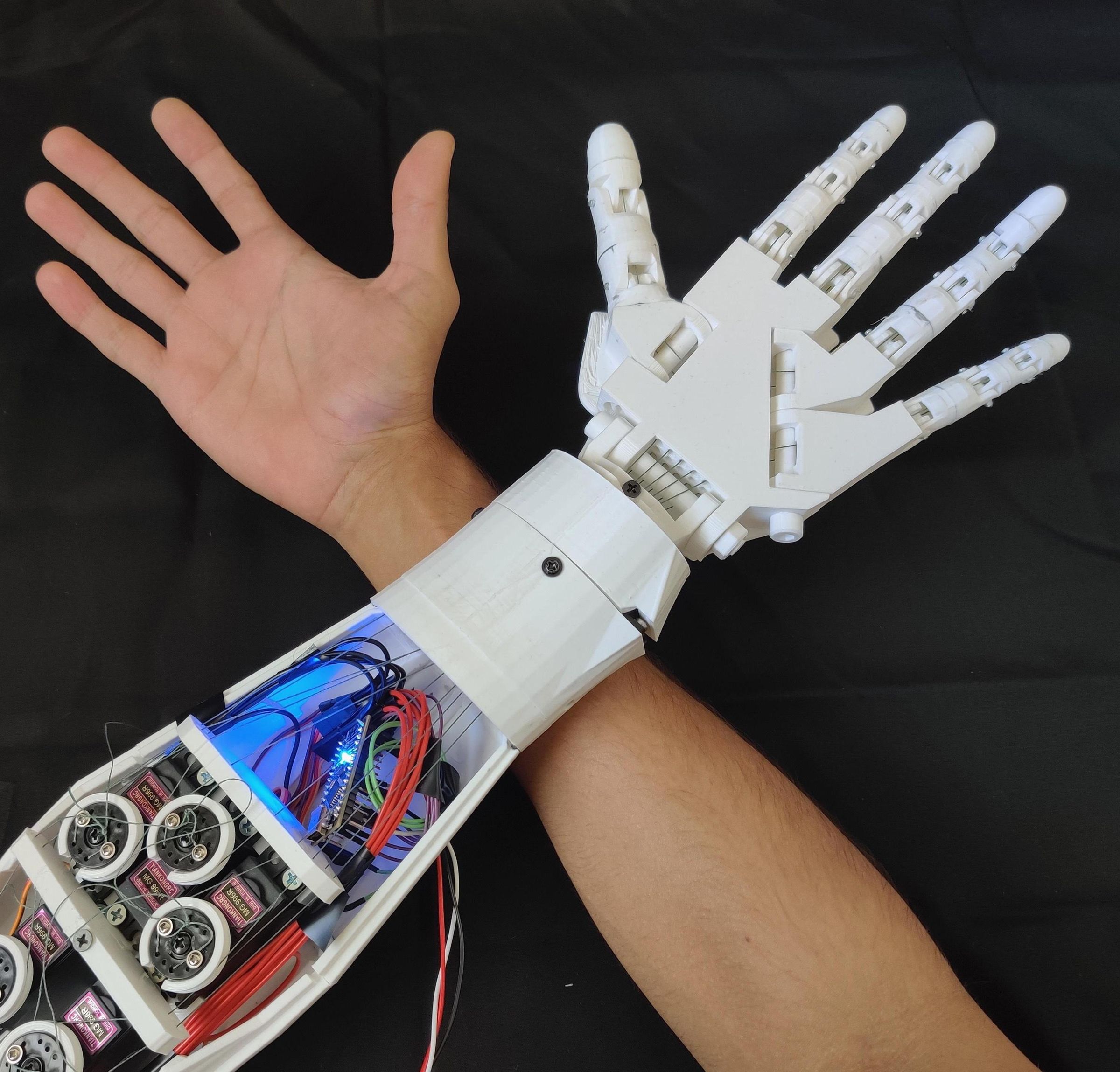

In this Instructables guide I will discuss how I added several different gestures to my 3D printed EMG prosthetic hand. If you haven't seen my previous post, I encourage you to check that guide first since I go more in depth on how I built my prosthetic hand. This guide will just be a basic summary of how I modified my previous prosthetic arm to be able to perform more gestures.

The code for this project can be found on my GitHub page here. You will need to install this program into two Arduino Nano boards (one controlling the index and thumb and the other controlling the ring, middle and pinky). In this program, we want to read the analog inputs from each muscle sensor and use them to independently control the servo motors corresponding to the different sets of fingers.
Step 3: Finger Control
In my previous hand, I used a single EMG sensor to control all five fingers. In this iteration of the arm, I used one EMG sensor to control the index finger and thumb and another EMG sensor to control the ring, middle and pinky fingers. This allows me to control the index and thumb independent of the ring, middle, pinky, which allows for new combinations of movements. With this set up we are able to achieve 3 grip patterns: fist (all fingers closed), pinch (index and thumb closed), and point (ring, middle, and pinky closed).
Step 4: Wrist Control
For this arm, I also wanted to add a functional rotating wrist. To do this, I added an additional servo and controlled it with a basic on/off switch. I had initially thought about using an accelerometer, however I wasn't able to get accurate control of the wrist with an accelerometer and figured that it would be simpler to use a switch instead. To use the wrist, flip the switch in the on position and the hand will rotate approximately 45 degrees in the clockwise direction. To return the hand to its initial position, flip the switch off and the hand will rotate back to its original position.
Step 5: Conclusions
While I was able to add a few more gestures, this is a still a work in progress and there is still more room for improvement. However, I am very satisfied with what I was able to achieve with the sensors and servos I had. I really like the aesthetic and compact design of the InMoov hand, especially how it is able to integrate a servo motor to control the wrist. I think with better seniors and smaller servos I might be able to add more gestures and achieve greater precision control of the hand. The possibilities are endless and I'm looking forward to finding different ways to improve my prosthetic hand.
