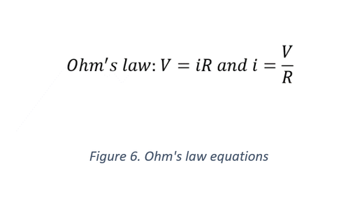

Step 3: Use Ohm's Law to Rewrite the Currents in Terms of Nodal Voltages
Ohm's law shows the relationship that exists between voltage, current, and resistance. Ohm's law is useful for solving for an unknown voltage, current, or resistance. Additionally, Ohm's law allows you to solve KCL equations for unknown nodal voltages.
Figure 6 shows two forms of Ohm's law. The first form, V=iR, allows you to solve for voltage if you know the current and resistance. The second form, i=V/R, allows you to solve for current if you know the voltage and resistance.

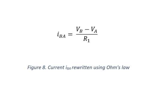

2. Use the second form of Ohm's law to rewrite the currents as nodal voltages.
Figure 8 shows the current from node B to node A rewritten in terms of Ohm's law. The notation of the current tells you the order for the nodal voltages in the numerator, and the denominator is dependent on the resistor between the two nodes.

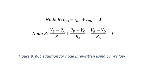

Step 4: Substitute the Currents From Step 3 Into the KCL Equations From Step 2
1. Use simple substitutions to replace the currents in your KCL equations with the unknown nodal voltages that you determined.
  • By doing this, you create a system of equations that you will be able to use to solve for the unknown nodal voltages.
Figure 9 shows the original KCL equation for node B and then the KCL equation rewritten using the unknown nodal voltages.
Remember that the nodal voltage of the reference node is 0 V, so you can leave that voltage out of your final KCL equations. Also, in this example, the voltage of node A is equal to the voltage of the voltage source, so it becomes a constant.

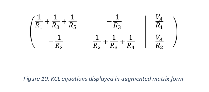

1. Create a matrix using your substituted KCL equations from step 4.
Figure 10 shows the matrix that you get using the KCL equations. On the left hand side, you place the coefficients of the unknown nodal voltages, and on the right hand side, constants of the equations. In this example, the nodal voltage of node A is on the right hand side because the nodal voltage of node A is equal to the voltage of the voltage source.
The first column should contain the coefficients of the nodal voltage for node B, and the second column should contain the coefficients of the nodal voltage for node C from both equations.
2. Solve the matrix using a method of your choice.
  • The simplest way to solve the matrix is to have your calculator solve it.
  • Here are some links to solve a matrix with a graphing calculator:
    1. TI-89: http://bit.ly/2dosQaf
    2. TI-84: http://bit.ly/2dorD2F
    3. TI-83: http://bit.ly/2djLrIs
  • Here is a link on how to solve a matrix by hand: http://bit.ly/2dwFyaW
  • The solution to your matrix contains the values of the unknown voltages. In this example:
    1. The first row will contain the value for the nodal voltage of node B.
    2. The second row will contain the value of the nodal voltage of node C.

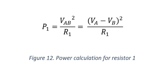

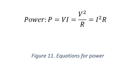

2. Solve for the power across each circuit element.
  • Use one of the equations for power to find the power of each circuit element.
Figure 11 shows the equations for power to use in finding the power across each element.
Figure 12 shows an example of a power calculation for a resistor using the nodal voltages.
