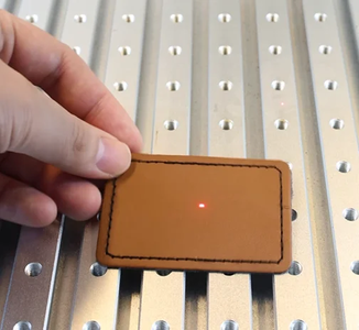

Step 1: Place the Leather
Choose a piece of genuine or PU leather. Wipe the surface clean to remove dust or oils, as these can affect marking quality. Place the leather flat on the laser bed and secure it with pins or magnets if needed.

Focus is the key to success. Once focus is ignored, the results may not be satisfying. Before you start, make sure you have finished focusing. With the Aurora Lite, you have two ways to achieve perfect focus. The first method uses the red-dot pointer to assist—simply adjust the laser head until the two red dots overlap, and you’re good to go. The second method, which is often more precise, is manual focusing with a focus stick. Adjust the height of the laser head until the focus stick just touches the surface of the material in a perfectly vertical position. Whenever possible, use manual focus for better accuracy.

When we click the “Frame” , we can see red light show the outline of marking area. It’s safe, and the frame will be on the surface of the leather labels. Once it isn’t, move your leather labels or design until they are at the same position. Once everything is adjusted, simply hit ‘Start’ to begin laser marking with the Aurora Lite.
