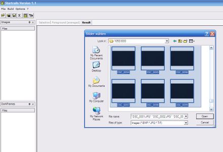

Step 3: Get Your Shots Ready
Pull all the shots off your camera, and get them ready for processing. Get that free awesome program up and ready, and load the photos. You'll also want to shoot a blackframe to stack in there with them. You get one by taking a picture with the lens cap on.
