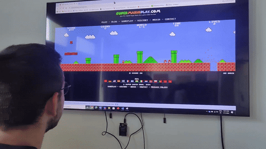

First plug the X-NUCLEO-53L5A1 into the Arduino Uno R4 WiFi, then fix the setup to a wall using Blu Tack, for example.
To play Mario, we need to perform 6 actions:
  • Standing
  • Moving right
  • Moving left
  • Jumping
  • Jumping right
  • Jumping left
Using a distance matrix collected from a ToF sensor, we can identify different signs, positions, poses, or other indicators. In my case, I found it effective to stand in different zones in front of the ToF sensor, as shown in the attached picture:
  • Zone 1: Jumping right
  • Zone 2: Jumping
  • Zone 3: Jumping left
  • Zone 4: Moving right
  • Zone 5: Standing
  • Zone 6: Moving left
Zones 1, 2, and 3 are close to the ToF sensor, while Zones 4, 5, and 6 are near the background.

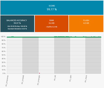

The benchmark will iteratively try combination of preprocessing and model on the data and evaluate the performances. It split the data into a training and testing set multiple times to have robust results.
The benchmark can take hours to finish depending on the amount of data used. If the score reach 90% or more, you can pause/stop it and continue. The benchmark will try to optimize the model as much as possible but you can stop it when satisfied.
In Validation:
During the benchmarking process, every time a new best library is found, it will be added to the validation step.
Once you have some good libraries, you can test them in real-time, as if they were deployed on the microcontroller, to see if they work well.
To do this, click the play button in the Serial Emulator column. Select the correct COM port and click Start. You will then be able to test the model and see if it performs well.
If you notice that some classes are having trouble being recognized, you can go back to the logging process and perform a new benchmark. For example, I had issues with the classes "Standing" and "Moving to the Right" when I was positioned close to both zones. So, I logged new data, ensuring that I did not stand in the same place.
In Compilation:
Simply click compile to get the trained model.
Step 4: Control the Keyboard
To play the game, we will use the NanoEdge AI Studio library to classify the required movement and the Arduino Keyboard library to send inputs to the PC and control the game.
Using the keyboard with the board can make it difficult to control your PC once the board starts sending input. To make things easier, I set a delay at the end of the setup() function. This delay gives you time to modify the code and flash it onto the board without interference from the ongoing inputs.
