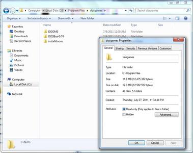

Step 1: Create a Folder
First you create a folder to store the files we will create in the following steps. I created a folder called dosgames in my program files folder on the C: drive.
To do this:
1. Open My Computer from the desktop or start bar.
2. Open C:
3. Open Program Files
4. Right click on white space within the file.
5. Move your mouse to new and select Folder.
-You may revive a message asking for permission to do this. Click yes.
6. Rename your folder by:
-right click the folder.
-type in the desired name of the folder eg. dosgames.
The location of the folder is:
C:\Program Files\dosgames
Because DOS dose not do spaces it is also called:
C:\Progra~1\dosgames
You can create the folder wherever you want, but make sure you know the location. If you are having issues with future steps then I recommend creating the folder at the same spot i have.

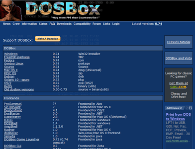

Step 2: Download DOSBox
We will be using a program called DOSBox to simulate DOS on the computer.
1. Download DOSBox here .
2. Clicking the link will take you to a list where you should choose your Operating System, OS.
3. After clicking the operating system you have there will be a 5 second delay before the download starts.
4. Download the file. It does not matter where the file is downloaded to as long as you can open it.
5. Opening the file will begin the Installation process.

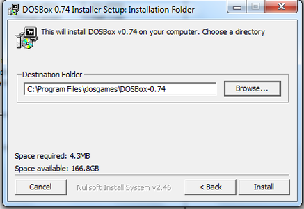

Step 3: Install DOSBox
With DOSBox downloaded you can now install the program.
1. Open the downloaded file.
2. Click next through the License Agreement.
3. Decide if you want a desktop shortcut for your DOS game and click next.
4. On where you want to install this installed, "Destination Folder", choose the folder we created in step 1; like in the image for this step.
5. Click install once you have chosen you creation location.
6. Click to close the installer when it is finished installing.

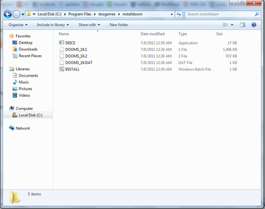

Step 4: Placing Install Files
This step is about placing the install files into the proper folder.
1. Create a folder within the dosgames folder from step one. This new folder is for the game Installation files to go.
example: C:\program files\dosgames\installdoom
or DOS format: C:\progra~1\dosgames\instal~1
2. Copy over all the installation files of the game to the newly created Installation folder in dosgames.
-If the game is on a CD then open the CD from "My Computer" and copy over all the files from the CD.

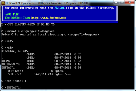

2. You will have a window open up that looks like DOS with a command line with Z:\
3. Type the following with the Z:\ command line (capitals do not matter):
mount c c:\progra~1\dosgames
- You should revive a message that says "Drive C is mounted as local directory c:\progra~1\dosgames\".
-If you revive an error then check that you have the proper spacing and name of the folders are correct.
4. Type:
c:\
-Now the z:\ should be a c:\
5. type:
dir
-you will see all the files within dosgames
6. open the game install file by typing (the dir command will tell you what the name of the folder is):
cd (name of the folder)
eg. cd instal~1
7. Type the name of the main install file:
eg: install
8. Follow the game install steps and save it in C if it asks for a directory
If no error occurred, you have sucsesfully installed your game inside the dosgames folder.

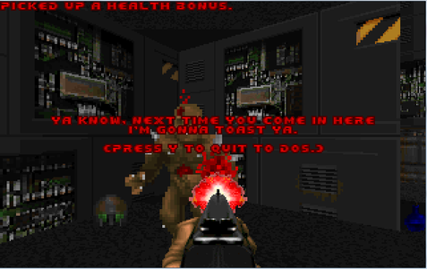

Step 7: Run DOSBox
When you run DOSBox it will open into the game that you told it to. Now your DOS games are a simple click away. To undo the auto launch feature go back to step 6, delete what you wrote, and save. Now that you can use a DOS emulator there are a lot of other emulators you can try, just Google search them.
