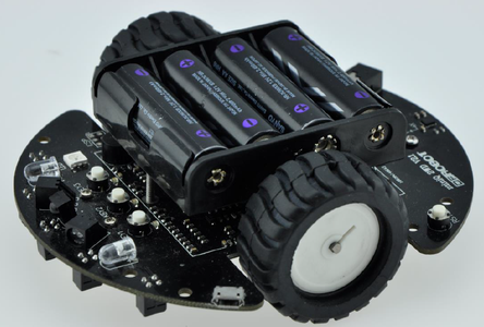

First of all,congratulations on getting such a nice robot kit! This is an interesting and fully functional robot,at the same time, it also can help you learn Arduino well. Make it a light hunter, coffee transporter or obstacle avoiding robot and so on. Now, let’s have a look at our robot:
Step 3:
1) MiniQ v2.0
Step 4:
2) LEDs on the bottom of MiniQ V2.0 Components explained:
Step 5:
1.Key
3) Components and locations
Step 6:
4) front view
Function about every component:
1. Infrared transmitter:transmit the infrared signal, the signal can be used for detecting obstacles
2. Photosensitive diode:sensitive with the light, so it can help you get some information about the light
3. Infrared receiver:receive infrared signal, the signal can be used for obstacle avoidance
4. Button:can be programmed for your idea
5. RGB LED:you can change its color use your code, it can show as an alarm and other things you want
6. USB port:upload your code and let your robot talk to your computer
7. Buzzer(passive):be an alarm bell or sing a simple song
8. Controller:runs your code
9. Motor:can be controlled to run forward or backward, so that the car can turn left or right freely
10. Reset button;Reset the robot, the program in the robot will runs again from its initiation
11. Power switch:power switch of the robot
12. Gadgeteer port: 2.0C port, can be used to any 2.0C component
13. Power port:power provided from this port
14. Magnet sensor:can be used for direction measurement
15. Charge port: if your batteries can be charged, you can charge them from this port thus they can be hold in the car
16. Infrared line-follow sensor: can be used for detecting for white or black lines

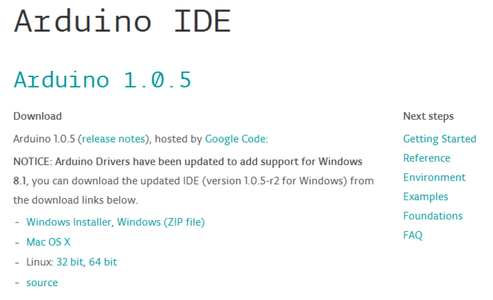

Program controls every step of your robot. So you must know how to upload your program into your robot. And firstly, you need to upload the software, this is the link: ArduinoIDE.
➢ Open the website: http://arduino.cc/en/Main/Software, you will see:
Step 8:
Points
5) Upload page
➢ You should upload the right version to fit your system of your computer, take windows for example: if you finish the upload and open the software, you will see:

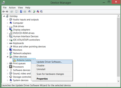

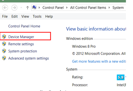

➢ Next step, install the driver. Open the device manager: Right click my Computer→Properties→Device Manger
Step 11:
8) Open device manager
You will see:
Step 12:
9) Unknow device
It shows we need to install its driver, you can install it by windows itself but it is faster do it yourself, right click Arduino Leonardo→Browse my computer for driver software→C:\arduino-1.0.4-windows\arduino-1.0.4\drivers→Next,you will finish the installing.
Step 13:
10) Install the driver

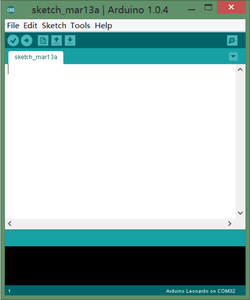

➢ After the action above, open the Arduino IDE, you will see:
Step 14:
11) Arduino Serial Port
Click “Tools”→“Board” to choose”Leonardo”, and “Tools”→”Serial Port” to choose the port.

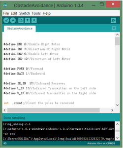

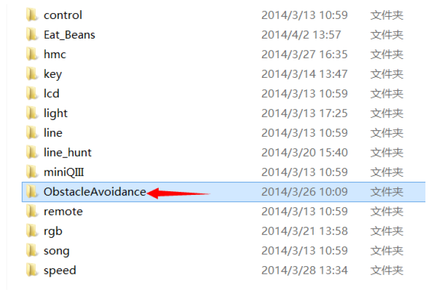

➢ Now,open the file“ObstacleAvoidance.ino”,
Step 15:
12) You need to open this folder
Step 16:
13) Program has bee opened

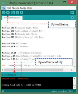

➢ Click the upload button and wait for the the message below.
Step 17:
14) Program upload
Well, take off the USB cable, put your robot on the ground and see what happens, it avoids the obstalce itself, doesn’t it?
