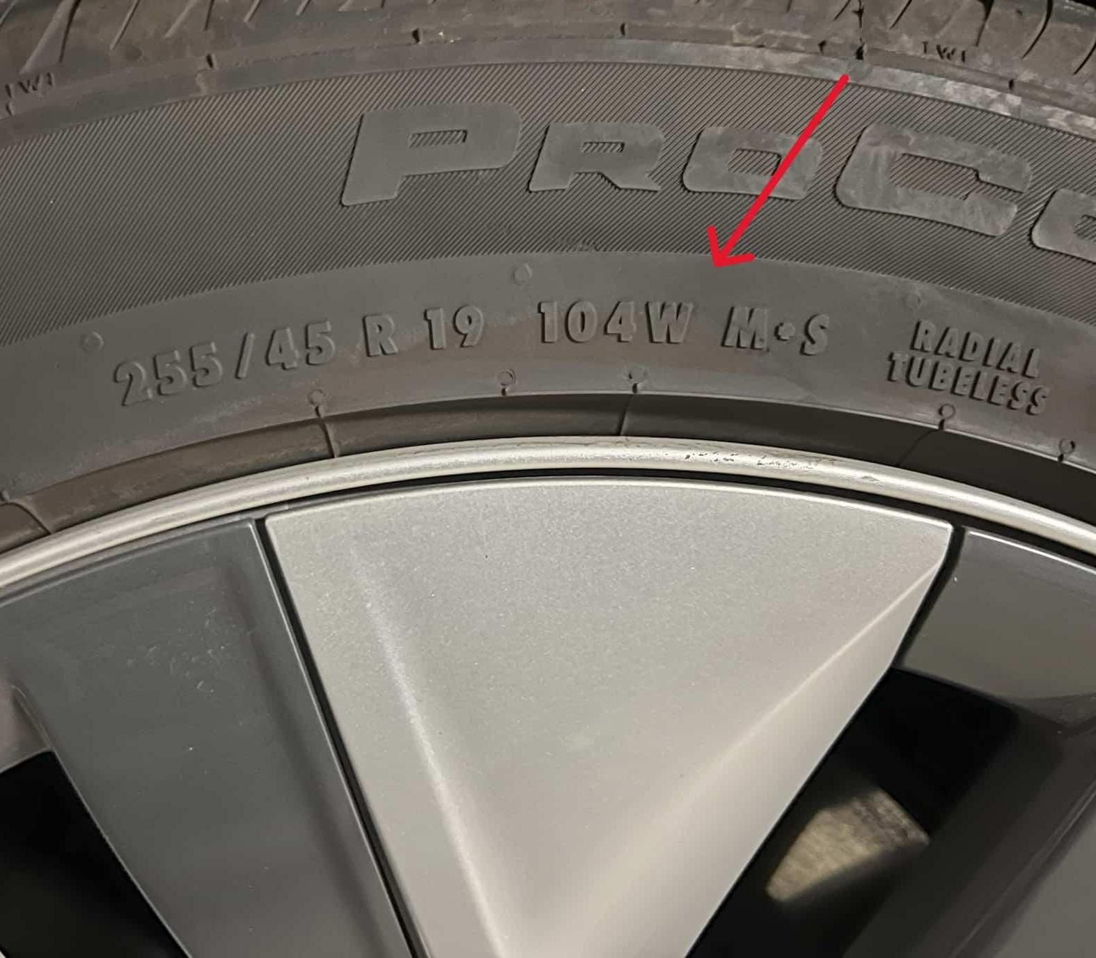

Step 5: Final Thoughts
Some people believe tire plugs are not a permanent tire repair. In my opinion, if a tire plug is installed correctly, it can be a permanent fix and last the entire lifespan of the tire. If the puncture site is on the sidewall of the tire or close to it, do not use a tire plug. The image above is an example of an unrepairable tire.
