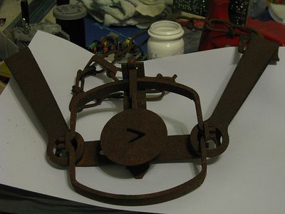

My definition for "prepared trap" is one that has at least one swivel and one spring added to the chain.
The point of the spring and swivel is to prevent the animal from breaking its leg. With a regular chain the animal can run and the jerk would break its leg(this is prevented by the spring) or the animal could twist and have the skin worn off of its leg and possibly break its leg(this is prevented by the swivel).

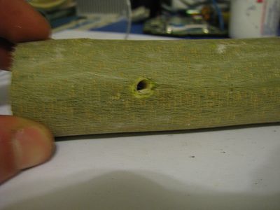

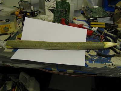

But just in case, the stake should be about the same length as your fingertip to your elbow and thick enough to safely drill a hole in. And it needs to be pointy on one end.

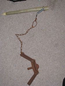

Step 3: Connecting the Swivel to the Trap Chain.

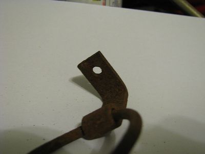

In this step you will connect one end of the swivel to the end of the trap chain.

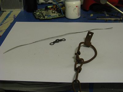

Grab your swivel, wire, wire cutters, pliers and trap.
My trap chain had this convenient piece of metal with a hole dirlled at the end attached so the swivel will go to this. but you can attach the swivel to a link in the chain.
This is probably the easiest step, with ~one foot of wire run it through the swivel and the LAST hole on the chain.(the last hole on my chain was the small hole in the piece of metal, but your last hole will most likely be the last link on the chain)
Then do whatever you need to do to keep the swivel from coming off. I just bent the wire in a tight "U" and twisted it.
Trim accordingly.
and you are done with this step!

Step 4: Attaching the Spring to the Swivel.

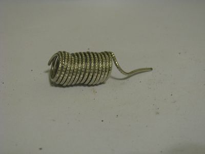

Ok, this is where it gets sorta tricky. Well, more tedious than tricky.

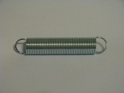

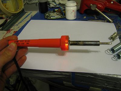

Grab your pliers(1 light duty needlenose plier and a slightly heavier duty needlenose plier helps a bunch in this step), spring, solder and soldering iron.

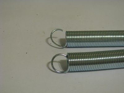

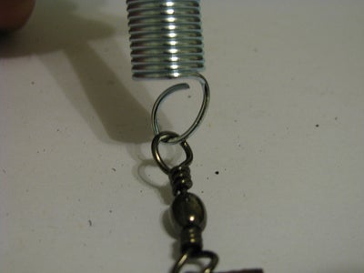

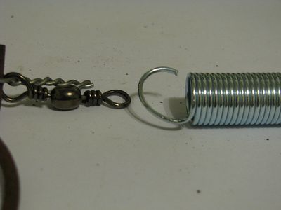

With the pliers bend the outer ring(on the spring) so that the end of the spring is exposed and you can slip the swivel on.
Slip the swivel on and then clamp the spring ring.
Once the spring ring is clamped there should only be a small(~2mm is good) amount of space the swivel can slide off.

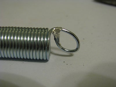

To prevent the swivel sliding off we are gong to solder the gap shut, with your trusty soldering iron of course!

In this step you will be soldering the spring ring shut and attaching the spring to the stake via lots of wire. And a previously drilled hole of course.
First of all, you need to repeat the steps needed to seal the ring on the end. Don't worry, you wont have to slide anything on so you can seal the gap before you attach the stake.

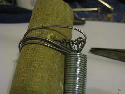

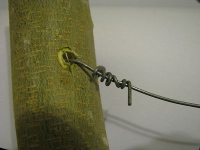

Cut a length of wire close to 4 feet and run about 1 foot of it through the hole in the stake.
Wrap the 1 foot of wire around the stake until there is ~ an index fingers length left.
Twist the finger length around the 3 foot of wire.

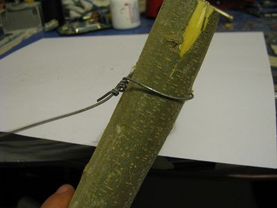

Then run the end of the wire(the long end) through the sealed hole on the spring.
Wrap the wire around and stake and then back through the hole on the spring several times, just make it "un-unwrappable" to your standards.
You can either solder the tag end to another piece of wrapped wire or just tuck it in somewhere.
