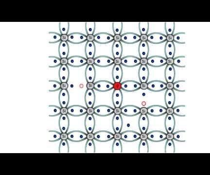

  • N-type Semiconductor: When a pure semiconductor such as (Silicon) is doped with a pentavalent impurity (P, As). The electrons in the n-type semiconductor are majority carriers and holes are minority carriers.
  • P-type Semiconductor: When a pure semiconductor such as (silicon) is doped with a trivalent impurity (B, Al). The holes in the p-type semiconductor are majority carriers and electrons are minority carriers.
