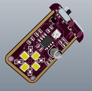

Since we are using the same circuit Schematic as the previous project then no changes to make in here except for the parts packages we will use the SMD ones instead of the Through-hole parts.
I also made PCB art for the routing around the LED pads to give an attractive looking of the gadget, Altium designer made it easy at this point and I can check the 3D view of my circuit design to make sure that everything looks okay before proceeding to the PCB ordering.
I then moved to JLCPCB and uploaded the GERBER design files to order the Printed Circuit Board and its related Stencil.

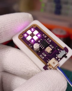

I then prepared a housing for this gadget and 3D printed it in PLA filament then I put the board to the housing and it fits in it very well.
Step 3: Make It Glow
All what we need now is an external 12V DC power supply to connect it to the main power connector, as soon as I turn on the device the LEDs start on breathing in a controllable rhythm that could be adjusted through the SMD rotary potentiometer.
