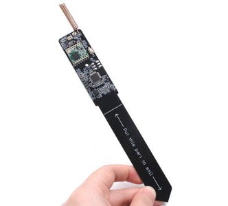

The LoRa soil moisture sensor is based on Atmel's Atmega328P, it collects local air temperature/ humidity with the sensor AHT10, and detects the soil moisture with capacitor-humility measurement solution with 555. The sensor transmits the reading to the LoRa gateway with LoRa communication. And it is very suitable to use to remind if the plants need watering in a garden.
The LoRa module onboard connects to Atmega328P with SPI and GPIO, the connection detail as the below:
Atmega328P ------> LoRa module
D12 ----> MISO
D11 ------> MISO
D13 ------> SCK
D10 ------> NSS
D4 ------> RESET
D2 ------> DIO0
D6 ----> DIO1
