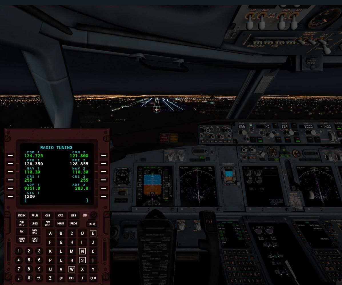

Introduction: How to Program X-Plane11 Default 737 FMC
One day I was flying in the x-plane 11 default 737, and I wanted to know how to put waypoints in the FMC. I searched online, and the only tutorials I could find were for the Zibo 737. Eventually I figured out how to program the FMC so now I am making a tutorial for less experienced players.
In this scenario, I will be going from KSAC to KSFO and my waypoints will be ALWYS->CEDES->ARCHI. My cruising altitude will be 5000ft, I will be going at 250 knots and my callsign will be AAL1738.

Step 2: Press FPLN on the FMC
Step 3: Press CLR to Clear the Scratchpad
Step 4: Enter Your Origin Airport's ICAO Code on the Scratchpad
Step 5: Press the Button Next to the Boxes for the Origin Airport
Step 6: Enter Your Destination Airport's ICAO Code on the Scratchpad
Step 7: Press the Button Next to the Boxes for the Destination Airport
Step 8: Enter Your Flight Number in the Scratchpad
Step 9: Press the Button Next to the Spaces for FLT NO

Step 13: Press the LEGS Button
This should take you to a screen like the one above.
