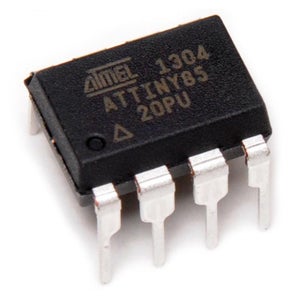

  1. ATtiny - There are many types but in this Ible' I'll be using a ATtiny 85 which is a pretty popular one - Ali Express

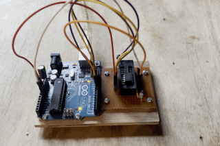

If you wanted to you could just use a breadboard for this part. However, I wanted something more permanent so I made a little development board to plug in the ATtiny to.
STEPS:
  1. Solder the 16 Pin ZIF Test IC to to the prototype board
  2. Next, add the 8 pin female header to the board and align them to the pins on the ZIF test IC
  3. To be able to run the 'blink test' I decided to also connect he LED and resistor straight to the prototype board. Check out the wire diagram in the image to see how to connect these parts together
  4. Cathode (Ground Leg) - Pin 4
  5. Anode (positive) connect one side to a 220R resistor and the other leg of the resistor to pin 3
Step 2: Connecting the Development Board to the Arduino
I wanted to have the development board and Arduino permanently together so I added them to a small piece of ply wood.
STEPS:
  1. Cut a small piece of plywood so it fits the Arduino and development board on it
  2. Place the Arduino onto the ply wood, mark and drill some holes where the mounting holes are on the Arduino
  3. Use some small screw and nuts to secure the Arduino to the ply wood
  4. Do the same with the development board. You'll need to drill your own mounting holes into the prototype board
  5. Lastly, use the jumper wires to connect the Arduino to the development board. I've included a wiring diagram to show you how to connect these together
