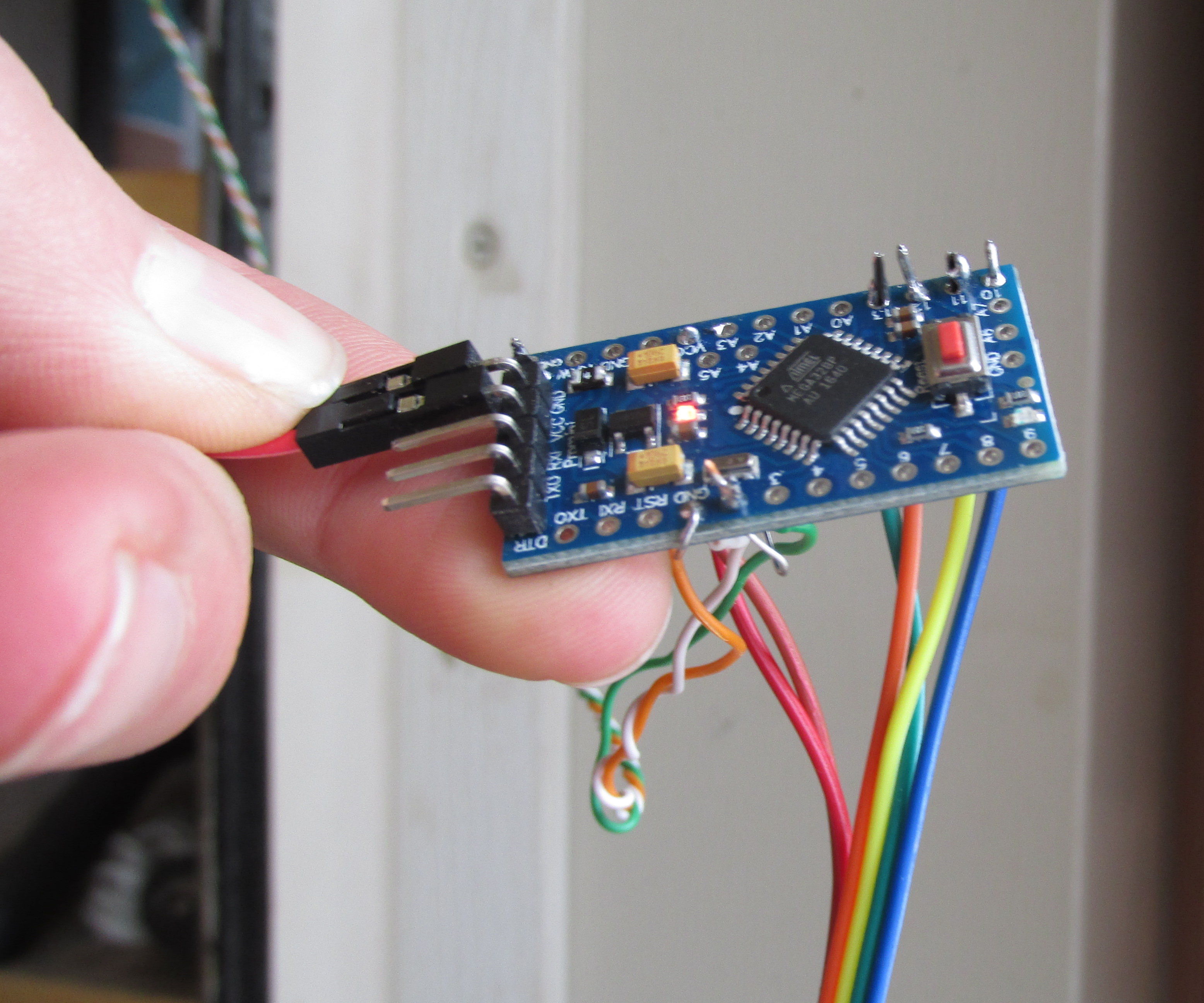

Step 2: Wiring It.
Connect
Pro Mini | Programing board
Gnd Gnd
Vcc 5v (or 3.3 for a 3.3 board)
Tx Tx
Rx Rx
Gnd to Reset on the programing board
Step 3: Programing.
Now it is ready to be programed in IDE select Pro Mini as the board.
Once the sketch is ready (no bugs) press upload, here is the tricky part as soon as it says uploading (not compiling) you must press the reset button on the Pro Mini.
