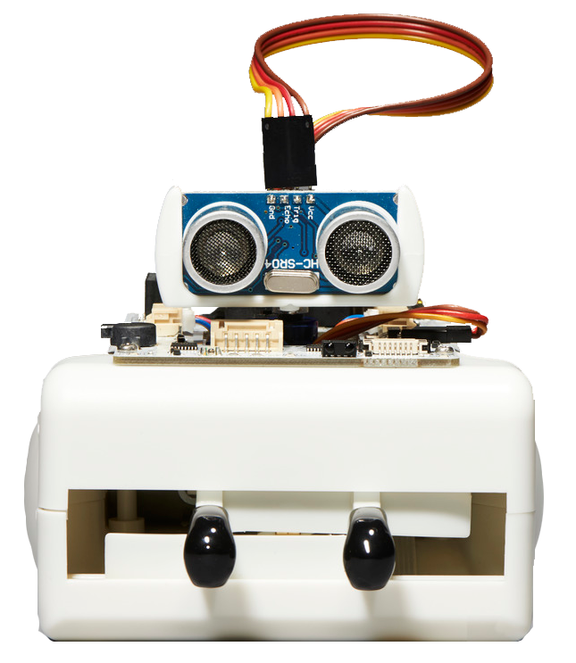

  1. Sparki rotates in its place, searching for an obstacle with its ultrasonic distance sensor (also called ultrasonic range finder).
  2. Once Sparki finds the obstacle, it advances (moving forward) towards it in order to expel that object outside the perimeter.
  3. The movement in the forward direction continues until a line sensor (or infrared reflectance sensor) detects the black line. That’s when the robot stops

Step 5: Program Sparki to Use Its Ultrasonic Sensor to Detect an Object in Front of It.
We need to stop the robot (using the sparki.moveStop instruction) when its ultrasonic sensor detects a close object in front of the robot.
Step 6: Now Combine the Previous Steps to Make Sparki Rotate Until It Finds an Obstacle.
Note: The complete code for the final version of this program is available at the end of this lesson. As you can see in the previous code snippet, everything is executed inside the loopfunction, which means that the code will be repeating until the robot is turned off (or the batteries are empty). And to be sure that we detect the object in front of the robot, we run another cycle (a while cycle) inside the loop, which ends each time the sensor detects an obstacle close enough (we set the detection distance in the while‘s condition). Finally, as the ultrasonic ranger has a conic detection zone, we added a small delay after the while, just to let the robot to center towards the detected object.
