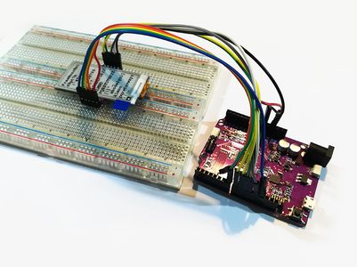

Step 1: Hook Up the Hardware
Here are the connections you’ll need to make from the display to the Zuino:
Zuino M UNO --------- Zio E-ink Display (4 models)
D7 ---------------------- BUSY
D9 ---------------------- RES
D8 ---------------------- D/C
D10 -------------------- CS
D13 -------------------- SCK
D11 -------------------- MOSI
3.3V ------------------- VDD
GND ------------------- GND
GND ------------------- BS

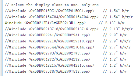

Before uploading the example code, we need to select the display class at the top of the code. This example code can be used for all of the four E-ink display.
Explanation for the comment:
“1.54” is the e-ink display size, “b/w” means the black and white color display, “b/w/r” means black, white and red color display. Remove “//” before “#include” to make the code usable, otherwise add “//” before “#include” if you are not using that model display.
