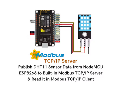

Step 1: NodeMCU and DHT11 Sensor
NodeMCU is a widely popular development board that is based on the ESP8266 Wi-Fi module. The board has built-in Wi-Fi capabilities and can be programmed using the Arduino IDE. DHT11 is a temperature and humidity sensor that is commonly used with NodeMCU. The sensor has four pins, VCC, GND, Data, and NC (Not Connected). The data pin of the sensor is connected to a digital pin of NodeMCU.
Step 2: Publishing DHT11 Sensor Data to Modbus TCP Server
To publish DHT11 sensor data to the Modbus TCP server, we need to establish a connection between NodeMCU and Modbus TCP server. The following code demonstrates how to establish a connection between NodeMCU and Modbus TCP server and publish DHT11 sensor data.

  • The above code establishes a connection to the Wi-Fi network using the WiFi.begin() function.
  • The mb.server() function initializes the Modbus TCP server.
  • The mb.addHreg() function adds Modbus registers for temperature and humidity.
  • The dht.begin() function initializes the DHT11 sensor.
  • The mb.task() function is used to handle Modbus TCP requests.
  • The dht.readTemperature() and dht.readHumidity() functions read the temperature and humidity values from the sensor.
  • The mb.Hreg() function saves the temperature and humidity values in the Modbus registers.
