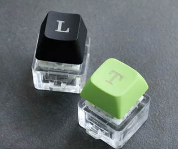

Step 6: Complete the Laser Marking
Once laser marking is complete, carefully open the door and get your personalized ABS & PBT keycaps. Laser marking does not produce toxic substances, and you can use it after a simple cleaning!
laser marking keycaps done
