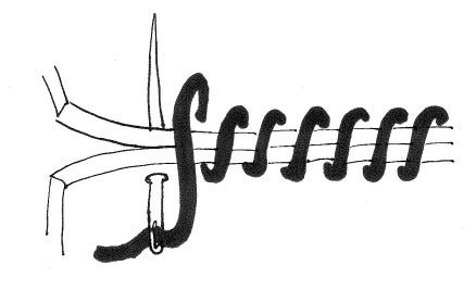

Now, sew around the curved edge of the pattern to make the pocket. Do not sew the straight edge because otherwise your pockets will be sewn shut and we did all this for nothing. I like to use the overhand stitch because it's basically the only stitch I know, but it works well for this situation.
New to sewing? Have no fear! First, check out this instructable's step 2 to learn how to thread the needle. I always double the thread because it's stronger. Then, check out the diagram that is attached to learn how to overhand stitch. Basically just put the needle in from one direction, pull the thread all the way through, and then repeat.
Remember (as I did not) to start your stitch about a half inch away from the straight edge. This will give you some extra material to more securely sew your pockets onto your pants.

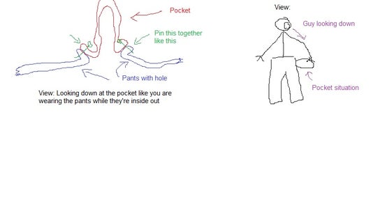

A little sewing lingo for you that I kind of introduced before: a "seam" is where two pieces of fabric get sewn together. The rough side of the seam is side you generally don't want to see, but it's the side that you sew on. That is why we like to turn the pants inside out while sewing. You don't want to see the rough edge of the seam when you are wearing your pants right side out.
In this case, you want to make sure that the rough edge of the seam will also not be on the inside of your pocket. You don't want your hands rubbing against that every time you reach inside your pocket.
When the pants are inside out, make sure that the rough side of the seams where the pocket meets the hole are facing where you can see them. Double-check that they're right. Imagine the pants being finished and putting the pants on. Where are the seams? Triple-check. And also make sure that the pocket is on right-side up. That's thirty minutes of my life that I'll never get back.
I found it pretty difficult to get a good picture of how I pinned the pocket to the hole since all the pieces are the exact same color, so you're going to have to figure this out on your own. I believe in you. I attempted to add a diagram, but drawing in MS Paint is not a skill I was born with.
Now sew! I recommend you sew all around the pinned areas first, and then come back and reinforce the top and bottom of the pocket's opening (those are the high-stress areas).
