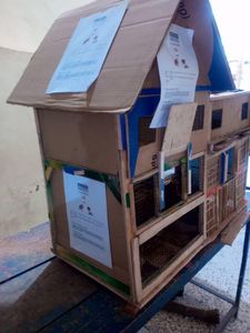

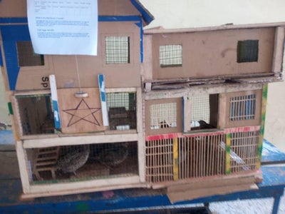

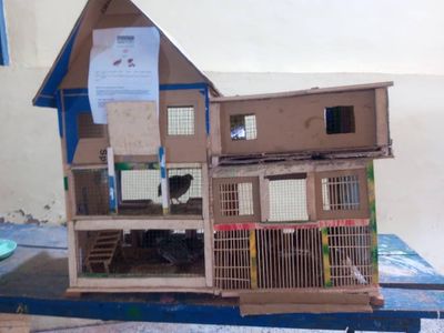

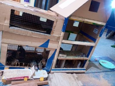

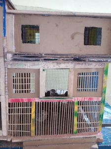

Step 1: Building the Quail House
Design the Layout:
  • Decide on the size of your quail house based on the number of quails you have. A good size for a small flock (4-6 quails) is around 2 feet by 3 feet.
  • Mark out the dimensions on the cardboard and wooden planks.
Cutting and Assembling the Frame:
  • Cut the wooden planks to create a sturdy frame for the house. This will serve as the skeleton of your structure.
  • Use nails or screws to secure the frame together.
Adding the Cardboard Walls:
  • Cut the cardboard sheets to match the dimensions of the frame.
  • Attach the cardboard to the wooden frame using glue. Make sure the walls are well-secured.
  • Reinforce the corners and edges with extra cardboard or wooden strips.

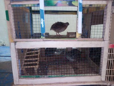

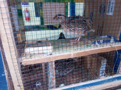

Creating Ventilation:
  • Cut out sections on the sides for ventilation and cover them with wire mesh. This ensures your quails get plenty of fresh air while staying safe from predators.
Adding the Roof:
  • You can use either cardboard or wood for the roof, depending on your preference.
  • Secure the roof in place and ensure it’s slightly slanted to allow water to run off.
Finishing Touches:
  • Add a small door for easy access to the quail house.
  • Place the house in a sheltered location, away from direct sunlight and heavy rain.
