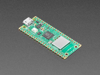

  1. Raspberry Pi Pico W.

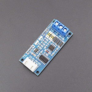

  3. TTL to RS485 converter.

  1. Connect the TTL to RS485 converter to Raspberry Pi Pico W
  2. Establish connections between Pico's UART pins (TX, RX) and the corresponding pins on the converter.
  3. Connect the converter's A and B terminals to the RS485 lines of the Modbus slave device.
  4. Power up Raspberry Pi Pico W using a microUSB cable connected to your computer.
